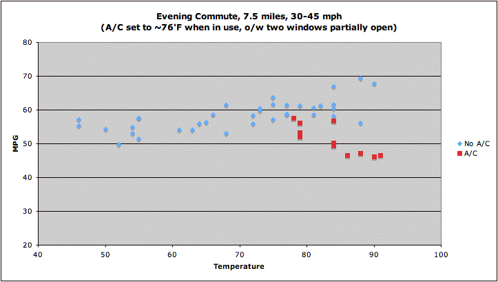

    A bit late to the party, but here is the data I've collected for my particular commute (speeds of 30-45 mph). I used the Scanguage II to read the mpg for the trip. I put the driver's window down 1/4 to 1/2 the way, and the back right window down 1/4 of the way. This gives good airflow without sacrificing too much aerodynamics. This is on a Gen II Prius, but should be fairly similar to yours.
