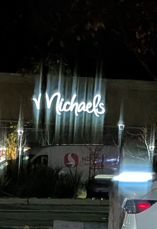

    This is a close approximation of what I see while driving (obviously my vision is more in focus that what I could get with the camera)

  6. Mayank Jain
    Mayank Jain Member
    Feb 20, 2018
    113
    73
    Cupertino, CA
    Thank you everyone, I was waiting for another rainy drive to respond back.
    I am using defogger, but i noticed that I keep the settings to pull in air from outside, with temp set to 71F
    I will try again with settings as mentioned by @BiomedO1
    Yes, i have an OEM heads up display which came with the car.
    I also have anti-glare glasses.
    I was able to capture a true representation of the problem. Then I asked my son to verify if it was just me or he was also seeing what I was seeing (See attached screenshot). Sadly he also confirmed it.
    As a second test, we tried looking at same lights from driver side and passenger side windows and there was absolutely no glow (as seen in the windscreen)
    Additionally, as soon as the rain stopped, the front windscreen visibility went back to normal.

    This only happens when it's raining?
    Because your original video had at least a half dozen spots that was stationary - mid-screen left of center. That would indicate an internal dirty windscreen, since the wiper blades went across them several times.
    Those still images could be junk on your camera lens, Why is the M in the michaels sign looks like someone blanked it out with a sharpie? Whomever cleaned your glass used vertical motion to do it, streaks.
    Swap out your glass, if it makes you happy, but I don't believe it's going to fix your issue.

    Yes, it only happens when its actively raining. The moment when raindrops stop, windscreen visibility is back to normal.
    My camera lens is clean, infact I had a new'ish phone that day. To make sure it was not something with my eyesight, i also asked my son and he described it similarly to what i was seeing.
    The video in the original post was perhaps not the best way to show it to you all as i was driving and trying to capture at the same time. This picture - car was stationary, so i could take a moment to capture correctly.
    I clean my car windscreen vertically, yes you are correct on that.
