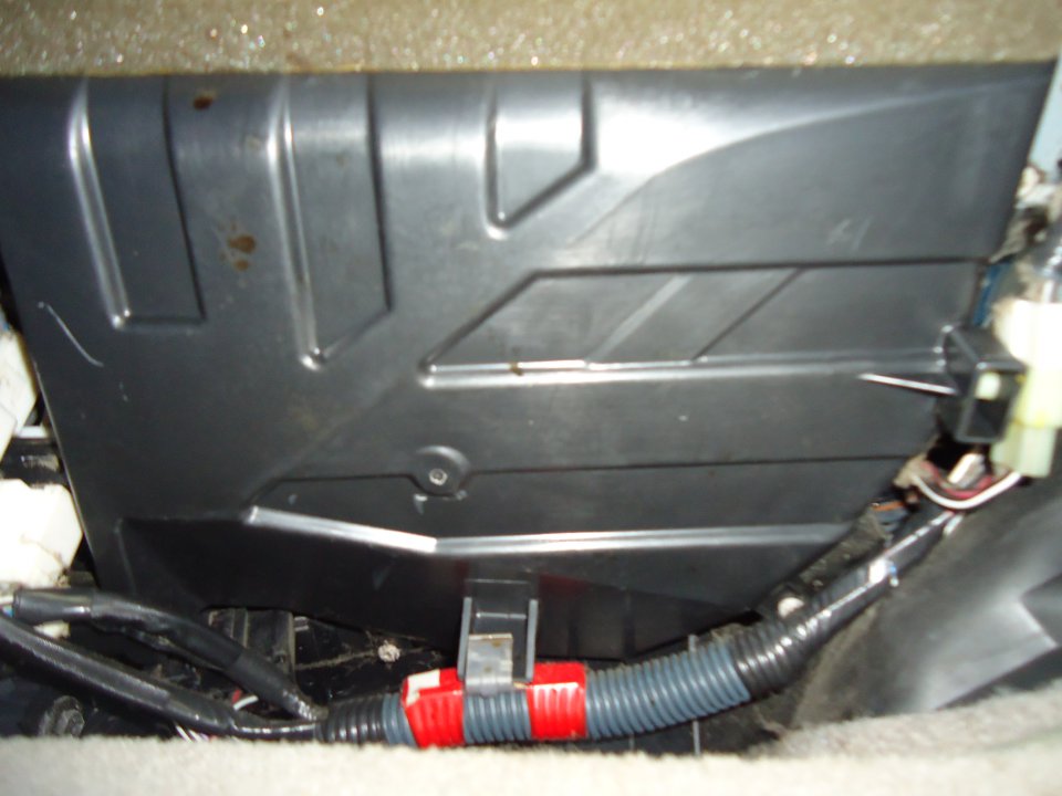

    It appears that blower motor has dirt in it. It shuts down. I have to remove the cabin air filter, rotate blower fan by hand and it starts to work. Need to know how to remove blower to clean it.

  17. hardish
    hardish Junior Member
    Dec 12, 2013
    2001 Prius
    Please see the picture attached. Can't figure out how to remove bottom cover to get to blower. Don't see any screws to remove. Am I missing anything?
  18. AlexY
    AlexY Member
    Oct 18, 2010
    163
    45
    UK
    I don't think so, air filter stopping anything that can block it, rather motor's brushes are out.
  19. kutcht1
    kutcht1 Member
    Nov 25, 2013
    305
    82
    Andover, Minnesota
    Try removing the glove box or something. The fan went in as I would bet the car was not built around it. Be sure to let us know asif it happens to somebody else they may find this thread.
    TomK
  20. hardish
    Dec 12, 2013
    2001 Prius
    I removed the glove box. Did not see any screws at the bottom of the blower to remove the cover to get to it.
