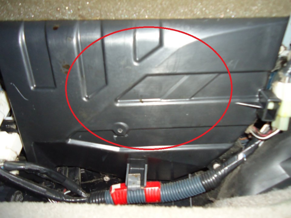

    I drew a red circle on the attached picture. Is that the plastic piece I need to cut out or more?
  5. ChapmanF
    28,753
    19,060
    No, that's not it. You'll probably really want to see how it's done in the manual, especially because the replacement part from Toyota only comes in one size and shape and so the cutting needs to be done so the repair part will still attach. $15 at techinfo.toyota.com is probably not too much to spend on making sure you know what you're doing ... especially if you use the opportunity to download as much other service info as you think you might want in the future.
