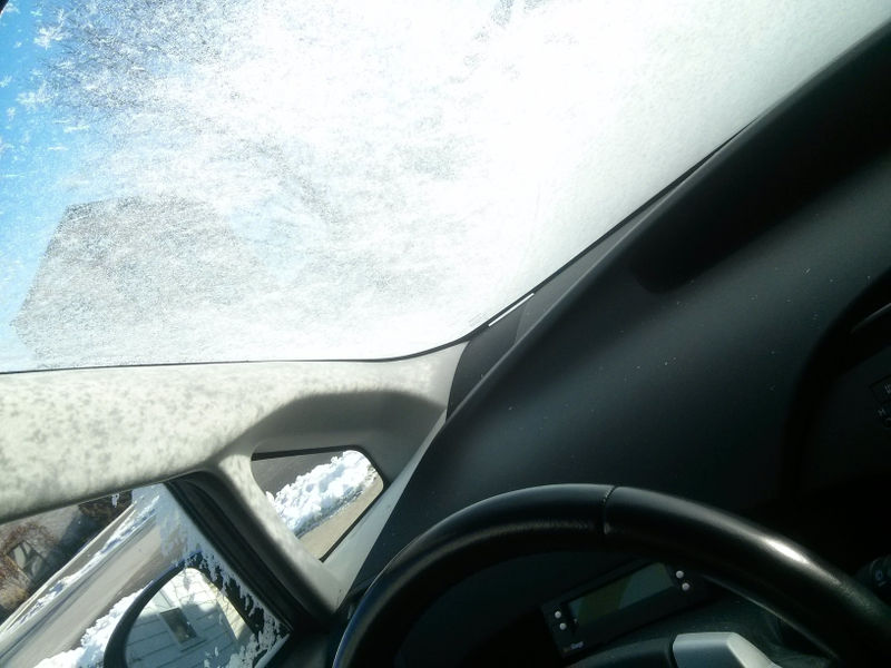

  15. ChapmanF
    26,332
    17,247
    It snowed off the inside of my windshield once. When I started the defroster to blow it around, it was a regular Interior Wizard-Blizzard.
    That's all on the inside. White specks on the dash are snow.
