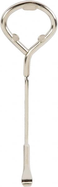

    Next time you pull those Christmas Tree nylon push fasteners off, you may want to use a paint can opener.
    They give them away at Lowe's or Home Depot in some parts of the world or you can buy them for less than $1
    They're also helpful with those 2-piece fasteners that all of the OEMs are crazy about using on wheel well liners.
    Every now and then a Christmas Tree fastener will go skittering across the garage if you're not careful, so it doesn't hurt to have spares, but they sell them everywhere.

    I swear by that paint can tool for the typical push-in fasteners. Unfortunately the fasteners on the hood liner are a different style: plain cap, wide head, with a very thin edge. Maybe a putty knife and traditional fastener pry tool, in concert, might coax them out in one piece.

    Best bet in this case might be traditional fastener pry tool, with masking tape to protect paint, under the felted liner as well.

    You mean the kind of fastener where there's a separate center button, you click it down, and that retracts the internal jaws. That's not these, at least not the hood liner fasteners on our Canadian 2010 (and I think Rebound's too): they appear to be a very skookum Christmas tree style fastener, with a plain head, wide and thin.
    Maybe this:
    (borrowing ETC(SS)'s picture)
    #35 Mendel Leisk, Apr 3, 2017
  16. ETC(SS)
    8,535
    7,550
    That's OK.....
    I borrowed it from somebody else..... :D
