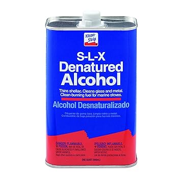

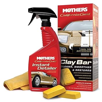

    1. CLEAN the windshield. Don't just use some spray cleaner like Windex. Clean it with denatured alcohol which is available at any home depot or hardware store. I've also had good results with using a clay bar (yes - the same thing you use to clean paint). It can pick up tiny bits of grime that get left behind. I've had good luck using those lint free microfiber rags you can find just about anywhere these days.

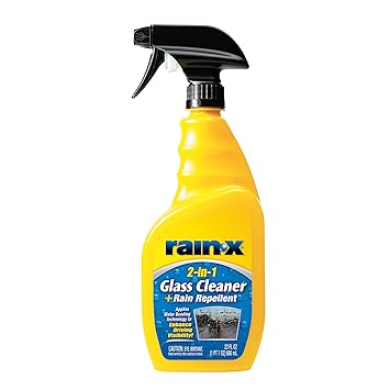

    2. Now TREAT the windshield. For about the past 5 years or so, I've been using the Rain X 2 in 1 glass cleaner and treatment. It works great - provided that you are willing to put in a little elbow grease and really buff out the glass. It is essentially putting a clear wax on your windshield that you look through so if you just spray it on and give it a quick wipe, you'll wind up with streaks and all kinds of a mess. Take some time and use a clean microfiber rag to really buff it out. Do this in the shade and on a cooler glass surface for best results.

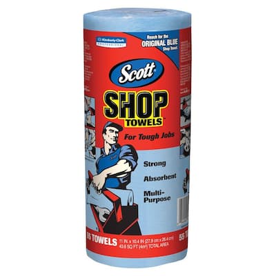

    3. CLEAN your wipers. Regardless of what brand you use, they will get dirty. Most people don't think of it, but try taking your wiper off and examining it. Most of the time, you can actually see crud built up on the rubber wiper. Unless you clean it, when you go to use it, you're just smearing that stuff all over your glass. I use regular soap and water. NO ALCOHOL or harsh cleaners here. That stuff will dry out the rubber and lead to premature failure. I typically use those blue shop towels on a roll to just wipe down each side of the rubber strip. You'll see the crud on your towel. Run it down the wiper several times till the black stops coming off on your towel. I generally make a habit of cleaning the wipers when I wash the car.
