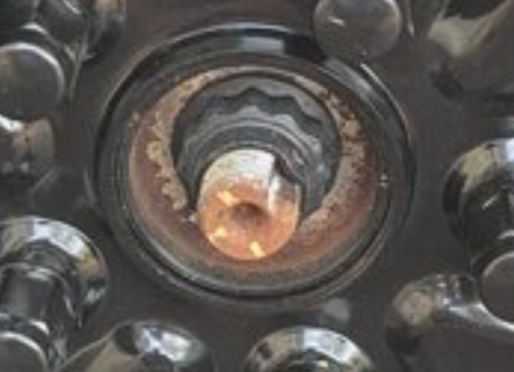

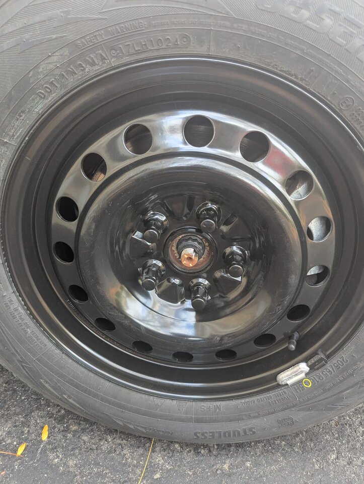

    I just installed winters and steelies for the first year, 16" 205/65R16 Toyo Obsererve GSI-6
    any ideas what i do with the exposed axles in the fronts?

    * Check the OD of that flange at the hub opening. And is it cylindrical or just a bulge? Hard to discern.
    on my gen 3 with Corolla steel rims, I found 2” ABS end caps (2.375” ID) were a “loose” fit, and if I first pushed on a rubber band fashioned from a bicycle inner tube, it became a slight interference fit, and tapped on with a mallet they stayed on:
    if something like that would work on yours hinges on the OD and shape.
    if you do nothing, have road salt, they will rust up pretty fast.
    A relatively unsightly but effective alternative would be to coat the zone with anti-seize. Best done with the wheel removed.

    Thanks for the reply,
    The flange looks like its flared a bit so i'm not sure fitting something OVER it will stay on. I'm thinking maybe an ABS end cap with an OD fitting the ID of the flange would work better?
    Is there nothing out there that can just thread on to that exposed thread? Anyone know the specs of that thread?
