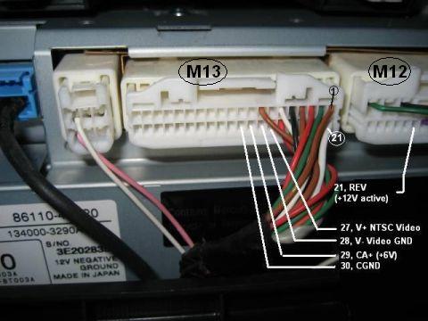

    The pic you showed indicates the pin numbers on the connector . In order to assign the pins to functions you need to go to the schematics section of the same pdf. The block diagrams show the pin number and the function.
    The german prius wiki contains several pages. You picked tve wrong one. Check 2006 Exe. It also contains the info on non nav cars. The pinout can be seen in the picture i posted before. Rev goes to m13, the right connector looking onto the back of the MFD. M14 is where the camera gets connected to.
    Marko

    You need to check:
    Rückfahrkamera_an_MFD_ab_2006
  12. ive
    ive Member
    Jun 8, 2013
    104
    43
    REV connects to pin 21, the sixth from the left, bottom row looking at the back of the connector.
    ITBland and R-P like this.
  13. ive
    ive Member
    Jun 8, 2013
    104
    43
    The names of the connectors in the picture are wrong. They are called M13 and M14. The pinout and function is correct. I checked both the schematic and my car plus my camera retrofit works.

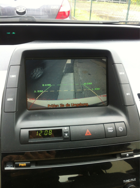

    Wireless Sony cam kit of ebay
  15. ive
    ive Member
    Jun 8, 2013
    104
    43
    in my european non-navigation model I need to get the REv 12V signal from the connector block on the left side on the bottom of the footwell as indicated in the priuswiki page i indicated above.
    In US models there seems to be a REV signal available on the right connector of the MFD. Unsure of this as do not haver such a car. if this is correct, you need to connect this REV signal to pin 21. No REV on pin 21 -> no camera signal as far as I know. But hell, what do I know in the infinite world of wisdom of the internet. I am just a poor bloke who read what was available on Priuschat and the forum on priusfreunde.de, studied the OEM Toyota schematics and got it to work....
