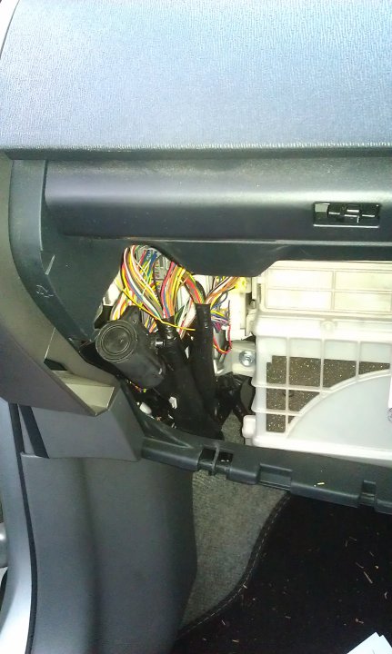

    GOOD NEWS EVERYONE, well an update anyway.
    Camera is bolted in, the image is so wide, any minor position change would be meaningless.
    I installed a lighter adapter power jack (with a protective door) inside the cubby below
    the stereo so I can power my Teclast tPad X80HD android/windows tablet or anything else...
    I made a "Y" cable to connect the power cable from the jack under the right side below
    the stereo console. No more cables dangling. Waiting for a 90 degree adapter for the USB
    plug so the cable isn't sticking out the end. The front bezel of the power jack needs to be cut
    to fit in the cubby. I used the 2 flat surfaces on the body of the jack as a reference to cut down
    the bezel, cutting one may have been enough.
    The tablet is running Dr. Prius with a Tonwon bluetooth OBDII adapter(Amazon).
    I made a S/Z shaped adapter bracket from a piece of light gauge aluminum flashing(homedepot).
    The S/Z adapter hold the bottom of the tablet and the other end hooks onto the open cubby door.
    There is enough play and tension in the cubby door to bend down and hold the tablet in place.
    Hope some of you find it useful.........;o)

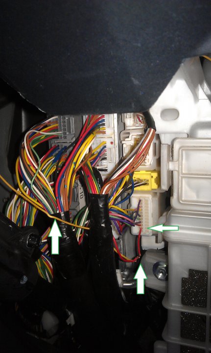

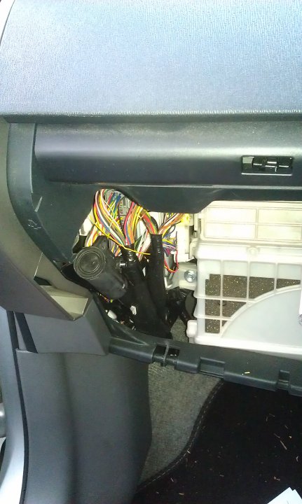

  5. JoqJoSain
    JoqJoSain Junior Member
    Jun 30, 2019
    Finland
    I found the IQ1 connector i think. It was under the drivers seat beneath the floor mat.
    I measured the connection to the camera t12 connector and it was ok.
    But i don't know where the cable goes from there.
    I was thinking maybe i'll just setup a new set of wire from the IQ1 to the M14 connector.
    The car has Toyotas Parking assistant but it doesn't work. I was thinking maybe the camera cable goes to some Parking assistant ecu or somewhere but i could not locate such a place.
    So if anyone know where the IQ1 goes before the M14 connector would be much appreciated.

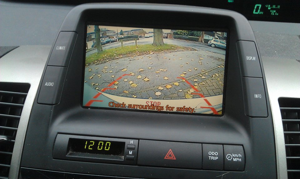

    Hello, I have problems with connection reverse camera on my Prius 2gen 2008.
    1. When I connect +12V to pin 21 on connector M12, I can't get on the pins 29/30 (M13) +-6V
    2. After ignition ON i get permanently on (M13) pin 27 -6v and 28 +6v. Is that right?
    3. In diagnostic menu, when I'll shift gear to R I don't get signal REV ON. Its permanently OFF.
    Thank You for any response

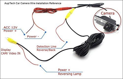

    Interesting, I'll try it!!!
    1. Display Power(+) → M14(Pin 21)
    2. ACC 12V POWER(+) → IQ1(Pin 6)
      ACC 12V POWER(-) → IQ1(Pin 7)
    3. Detection Line → IQ1(Pin8 )
    Above all, am I correct?
  14. Mibee
    Mibee New Member
    Apr 24, 2023
    Taiwan
    1. Display CAM/Video In(Red line) → M14(Pin21), Can I only insert the line?
      Power(+) → leave it?
    2. ACC 12V Power(+) → IQ1(Pin 6)
      ACC 12V Power(+) → IQ1(Pin 7)
    3. Detection Line → IQ1(Pin 8)
    above all, am I correct?
