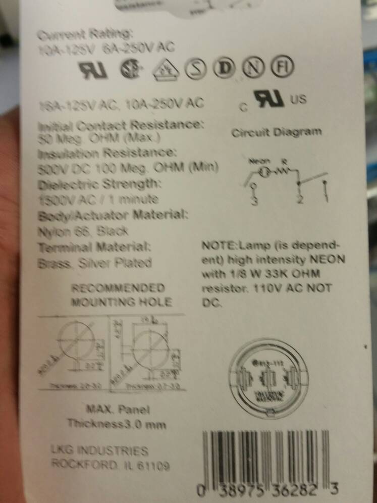

    To be honest the wiring diagram on the switch packaging was a bit confusing. When i get home, i'll take a picture of it to see if possible i do have it wrong. No, the led does not light up - at all. I do have an ohm meter but honestly do not have a clue how to use it.

    Post the switch wiring diagram.

    That is the wrong switch as it is for a 120VAC system. You need one that is set up for 12v with and LED, not a neon light.

    To be blowing the fuse at the 12v input source, you have to be creating a dead short, so your switch terminals are wrong. Basically, you are switching the 12v + directly to ground and not into your relay terminal 85.

    Good catch, i just ordered this as the local store didn't have anything small like what I wanted, only large trucker parts. Figures.. I live in Alberta.

    Appreciate the help thus far, but since I already purchased the two relays and it currently works when the car is in reverse, the only thing left is to find out why the switch isn't working. Once I get time, I'll try a switch that is rated for 12V DC and not 120V AC.

    All valid points. I tried swapping the relays and the reverse still worked. It was the switch.
    I picked up a 12V DC switch, made sure the correct posts were connected correctly and my issue was resolved. No need for diodes...the dual relay with 12v DC two pin switch fixed it all. I was in a electronic store and just assumed that the switch I bought was automotive because I was in the switch aisle where the automotive switches were and someone had put the switch on the wrong peg. My mistake for not looking over my items before purchasing. :rolleyes:
