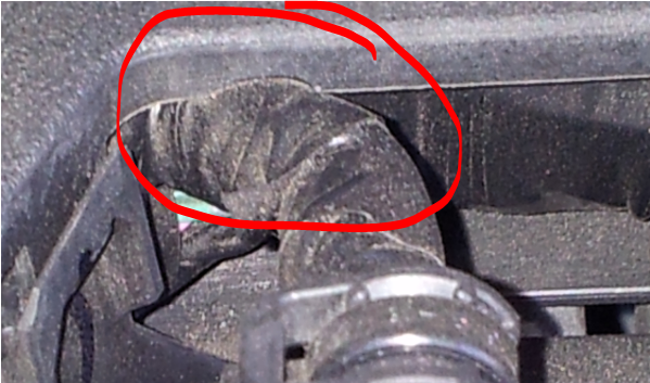

  17. alanclarkeau
    alanclarkeau Senior Member
    Feb 24, 2016
    7,045
    7,593
    near Brisbane, Australia
    They appear to have wrapped both sides on mine. The other (left) side had the obvious "digging" into the harness.

  19. alanclarkeau
    Feb 24, 2016
    7,045
    7,593
    Mine was done on 14 November - the Australian original recall had only just been sent out by then, but I haven't seen details of the recall. My suspicion is that they saw this and decided to do both sides:
    The wrapping quality isn't flash (see my photo Post #17) - or maybe I'm fussy. I've got a daughter who creates bridal gowns for the prestige market and she'd be disgusted.
