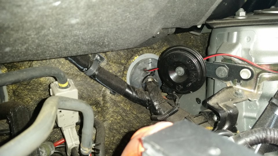

    i notice when folks are adding accesories etc that need to bring wire into cabin area......use all kind of contorsions and twists and turns all over the place,......when in fact its quite simple
    check picture below
    all i did was force coat hanger wire tru rubber[quite safe]...once it went tru i tape my accesorry wire to coat hanger and pulled tru further from inside cabin[torch is helpful]....and voila undo the tape ...now my wire is inside
    and there is room for many more.......the rubber is "self healing" and will tighten round the wire nicely...sealing it

    Which grommet is this?
    If it is the one that comes through near the brake pedal, those of us who know about the oem foglight installation know about it.
    Your picture doesn't look like it though.
    P.S. Is that a horn? What's it doing all the way back there, by the firewall/strut tower?

    right hand drive car. .. i brought wire through passenger side. ... so that is passenger side. .. maybe left hand drive is different. ..
    hardly much different?

    Still, what grommet/hose is that? The AC evaporator? The heater?

    bunch of wiresfrom engine area going into cabin. ...not pipe or ac stuff.....

    I believe it is the main wiring harness.

    I'm going to be running one wire through soon. There is a "nipple" that I'm going to try to deal with. Fog light instructions say to cut it off. I don't seem to see it in the picture. It seems like a very difficult reach until I read your coat hanger idea. Thank you so much!
