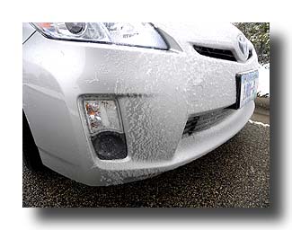

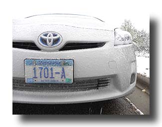

  10. john1701a
    john1701a Prius Guru
    Jan 6, 2004
    12,818
    5,303
    I block the bottom entirely and leave the top open. (Some owners partial or total block the top too, but carefully need to monitor temperature.) That works well for the 2010+. For the Iconic (2004-2009) model, you need to leave some of the bottom open but can block the top entirely, since the cooling components have a different internal arrangement.
    [​IMG] [​IMG]
    Squeezing the foam in between the grille slots keeps it looking nice. The catch is, you have to notch the inside every foot to make it lay flat. But the process is quick & easy.
    Keep in mind that the bottom grille gets pretty dirty from all the sand & salt. So, there really isn't much to consider cosmetically anyway.
    It stays snuggly in place too, all winter long... even with multiple runs through the car wash.

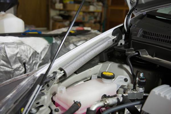

  17. Mendel Leisk
    60,237
    41,436
    Here's another place you can insulate, holds the engine heat in. This I leave in year 'round:
    (the foam tubing, center of pic, seals gap between fender lip and hood)
    john1701a and hybridbear like this.
  18. David Beale
    David Beale Senior Member
    Jul 24, 2006
    5,963
    1,989
    Edmonton Alberta
    Good idea Mendel. Is it wearing the paint on the underside of the hood?
  19. Mendel Leisk
    60,237
    41,436
    I think it was this member who fielded the idea:
    Ferls80 | PriusChat
    As far as I can see, no wear. It's similar to having a sealing gasket (like door seals0 I guess: slight wear over the years, but not much. And it's not visible.
    hybridbear likes this.
