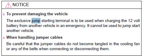

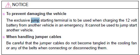

    There was a caution in the Owners Manual, to not use the under hood connection, hook up directly to the battery, when jump starting the Prius.
  12. Tideland Prius
    45,413
    16,656
    It's the opposite, not? Pg 544. You can use the under hood connections to jump start the Prius but you should connect to the 12V battery directly if you're jump starting another vehicle.
    Also, that warning/suggestion is gone from the Gen 3 manual. In the Gen 2 manual, it recommends against jump starting another car.
  13. Mendel Leisk
    61,296
    42,164
    You're absolutely correct regarding the hook-up, lol. Hey, I was only 180 degrees away...
    I suppose you could use the posts, but no need. Actually, 8 oclock day one with our car I was watching the service dept do just that. They finally caved and gave us a new 12 volt.
    And yeah, it only says don't use the underhood for jump starting another vehicle, kinda leaves you hanging, regarding the question of whether it's permissible. I'd be inclined to not.
