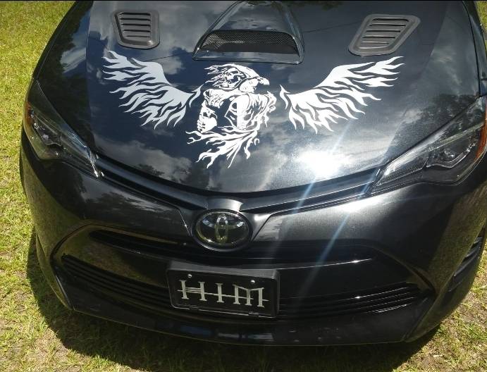

    Cut some holes in your hood and slap some scoops on the hood so the hot air in the engine bay can vent outside.
    Graphics optional.

    Maybe, but at a stop light air isn’t going in those vents itself so a manual radiator fan switch would help more at stop light heat soaks.

    Install the vents with the openings facing the rear of the car, the radiator fan blows front to back and the hot air rises naturally where it will vent at the rear of the hood. Installed this way, they are vents not scoops.

    Yes that would be nice, and then seal them off during the winter and disable manual switch to radiator fans too as I learned in real time and here that Gen 3 needs to contain engine bay heat to not get so low in temp that ICE is always running to stay above 130 degrees or something. Resolved with grill blocking.
    What is that car in the picture btw?

    IDK, a random car that popped up when I searched for hood scoops/vents.

    Im going to guess a Toyota Corolla late gen.
