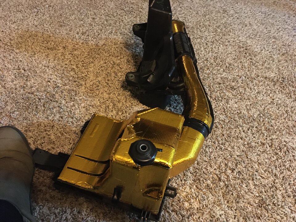

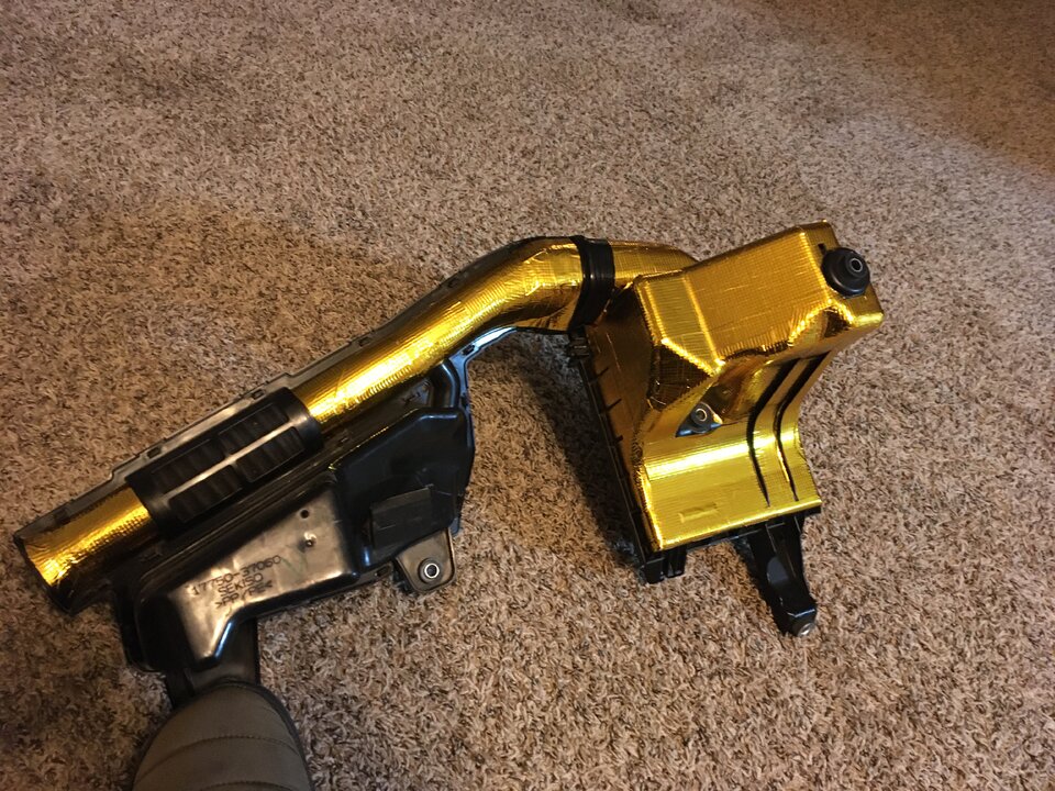

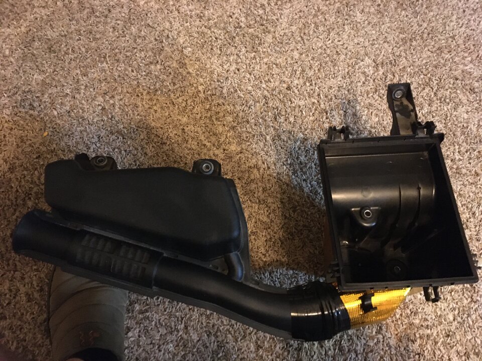

  7. h1ph0panonymous
    Oct 9, 2023
    258
    36
  8. h1ph0panonymous
    Oct 9, 2023
    258
    36
    As expected, decreased heat soak temps from stop light to stop light driving especially in combination with cabin exhaust method with the fan speed to 2 notches. Took an hour or two to take out the intake assembly and cut out a hundred jigsaw pieces of the reflect a gold tape to cover the whole underside of the assembly, left the top of it alone because it’s a porous plastic material and can see it not adhering correctly with the tape but mostly because most the engine heat radiates from under there.

  10. h1ph0panonymous
    Oct 9, 2023
    258
    36
    I ended up not using the bubble wrap tinfoil stuff, only used the reflect-a-gold DEI tape on the complete underside of the air intake assembly for obvious reasons. Yes a small gain is still a gain when it comes to lowering heat soak temps. Even at highway driving speeds I noticed decreased temps albeit 1-2 degree lowered difference. The bubble wrap stuff I’m still theorizing where or on what that could be used best, it also deals with condensation so could use for those type of applications as well.
