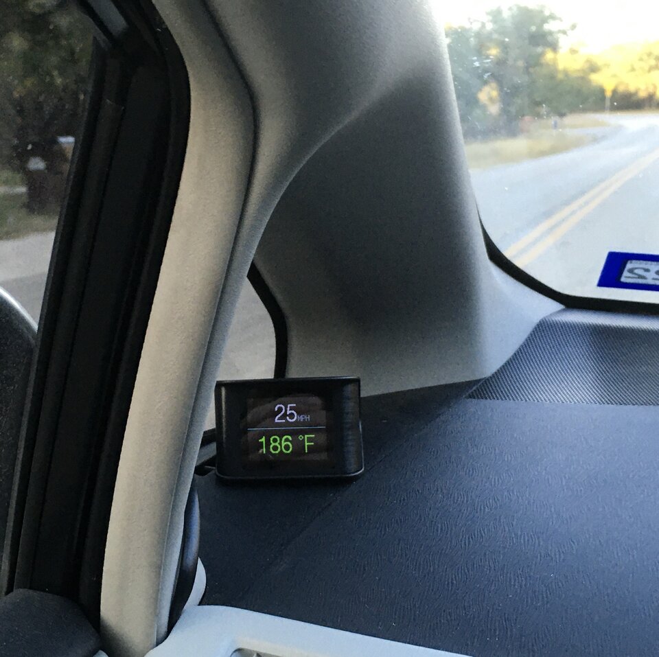

  7. rjparker
    rjparker Tu Humilde Sirviente
    Jun 6, 2008
    10,072
    6,238
    Texas Hill Country
    My v water pump shuts off immediately with the engine until full warmup. Then the short delay. I am sure it helps mpg but is likely to cause cylinder hot soaking. It's something I noticed maybe ten years ago when I observed significant thermal cycling of the engine when not moving but still in Ready.
    Using throttle to run engine in Ready
    Which was the reason to start realtime coolant monitoring with a 210f alarm.
    No tin foil but frequent coolant changes.
    #107 rjparker, Jul 12, 2025
    h1ph0panonymous likes this.
