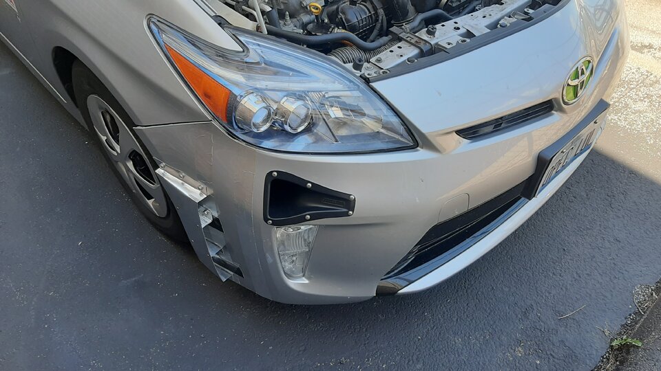

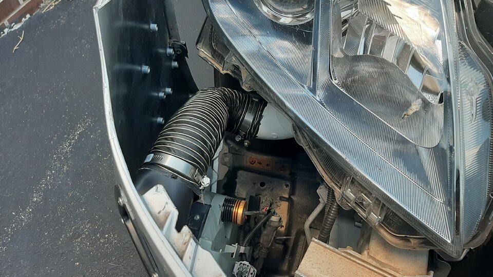

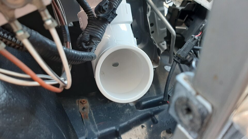

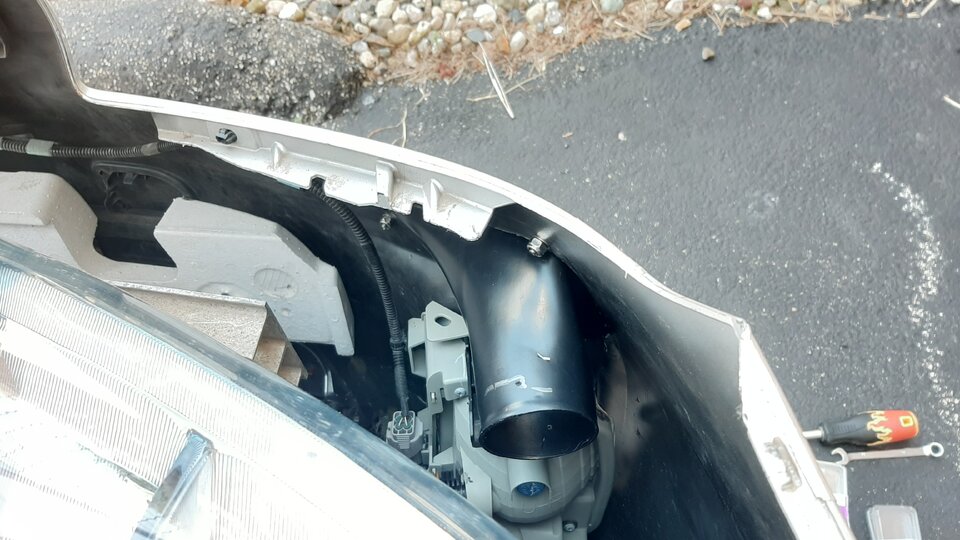

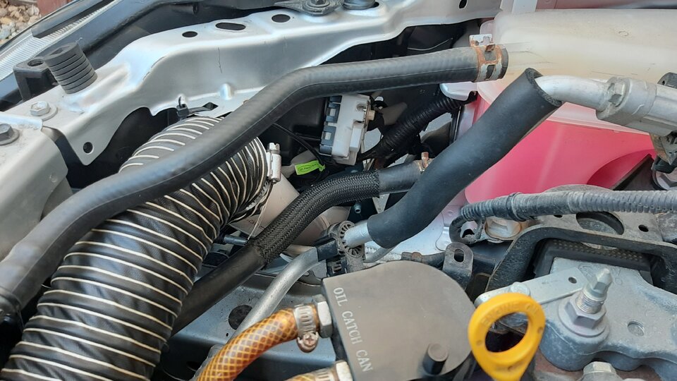

    Well, I hesitate to help out OP because they seem like a real...nice person, but since I am (AFAIK) the only person who has done something similar to what they're asking, here you go.
    This was completed almost exactly 5 years ago and has been through downpours so heavy I had to stop driving due to lack of visibility.
    External intake, flex tube + PVC elbow (with extra drain hole; there's one in the airbox but can't hurt to have another at the new low point). Note that this only fits because the windshield washer system has been removed; that normally takes up this volume. There is nowhere that I could find to route the intake air from in front of the radiator, as Gen 4 and 5 do.
    IAT at ~90F ambient has been reduced from 12-14F over with no duct (airbox open to engine bay directly)/10-12F over with stock duct (open behind passenger headlight) to 3-5F over (read by a Scangauge II). This doesn't appear to affect coolant temperature.
