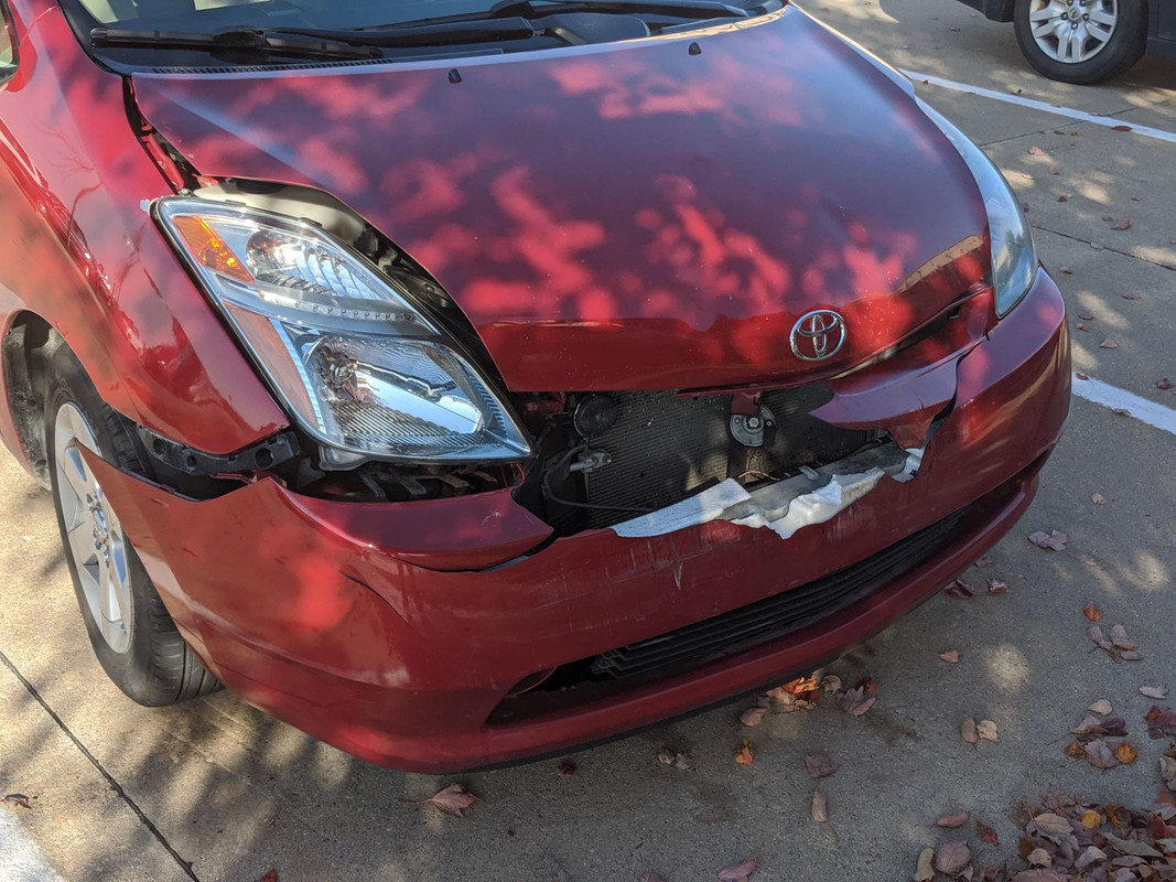

    So as the title says, I was involved in a minor wreck in my Prius. Oddly enough, all it did to the Camry I rear-ended was put about an 10" wide dent in the rear bumper, while it did much more to my car. I was going about 10 mph.
    Here is the pic the day of the accident.
    Good news: no airbag deployment, the windshield is fine, and so is the tiny windows near the doors.

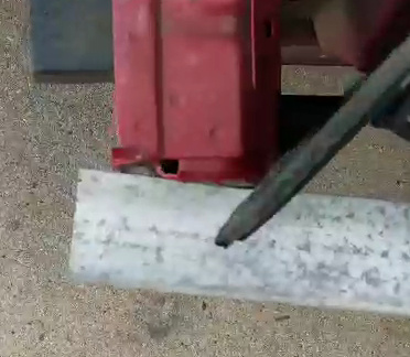

    Bad news: I'm going to have to have a body shop fix a few pieces of bent metal that is not removeable.
    The aluminum crash bar is going to get replaced as it was bent somewhat in the wreck. It can be had new rather cheap. It also pushed the rail in about 1/4".

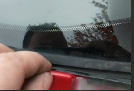

    It pushed the pillar in slightly near the windshield, but I can't see where anything else buckled, unless it was like that before.

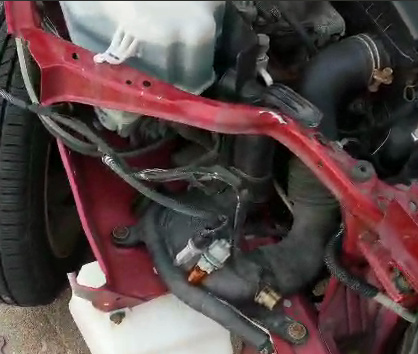

    This is the only piece of non-replaceable metal that got bent.

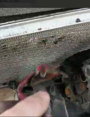

    It sent the center beam into the A/C condenser and poked a hole in it. I've already removed it and capped the lines.

    1. What am I looking at to have the AC system flushed and filled? Should I have a dealer do it, or an independent shop?

    The frame is not compromised. That rail in the first pic is pushed in a tiny bit, that is it.
    The aluminum crash bar can be had new for about $50, if not I can find another one at the JY off a non-front-end-wrecked Prius.
    The Styrofoam is cheap too.
    Yes, stupid of me to not have collision coverage, but I'm broke.
    The hardest part of repair is getting all the plastic shrouds back in the right place. There are like 10 of them underneath and alongside the sides.
    That rail that holds the headlight and washer tank is the only thing that was bent. I will figure out next spring if it will be cheaper to get that part bent back, or a new one welded in. A new one is like $40 from Toyota, it will be painted black from the factory, but anything that isn't seen on the outside, I don't care what color it is.

  5. lech auto air conditionin
    Sep 5, 2011
    830
    606
    261
    san francisco
    as for the a/c you already seal and plunged the end of the lines so you are good there. It will not be sitting exposed to the atmospheric for the next few weeks.
    Your new condenser will come with a new DRIER DESICCANT sock (bag). You will pay a few more $$$ for a Denso condenser but i Highly recommend it.
    If you can kindly ask the shop preforming the A/C recharge to at least leave it on the vacuum for at least a hour. Some plow right through it in 15 min save time make more money.
    if money to buy the ND-11 oil is not a option. Then a alliterative
    it will be better then what has been open to the moist air sitting in the shop for months or years. It is not that garbage sold in a plastic bottle at the auto parts store. Moisture actually go through plastic. The auto parts store POE and PAG has been sitting for years.
    40ml. oil added for the new condenser
    gusstament for oil loss from puncture and rapid loss of refrigerant in liquid state from condenser ( 20ml )
    total = 60ml.
    give the rest to the shop. it had been open and will be bad soon. The shops will use it any way.
    no need to flush you a/c system. you sealed it.
