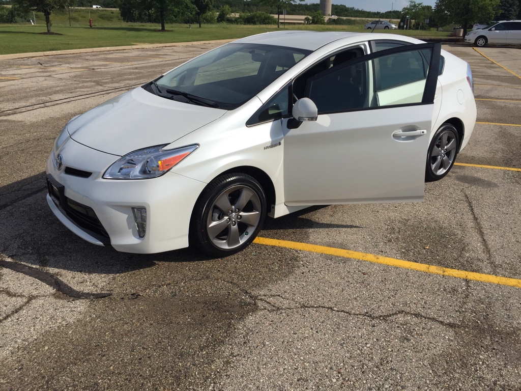

    Just picked up my new '15 Prius Persona today!!![​IMG]

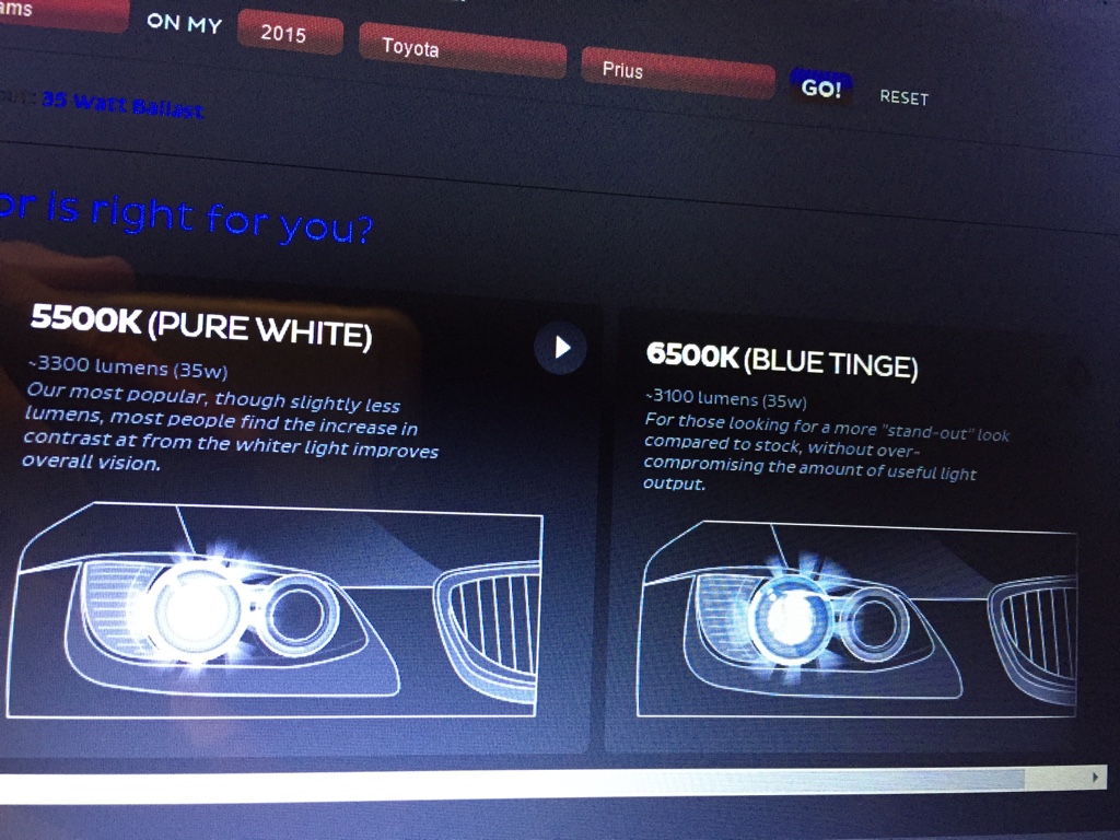

    I was thinking of going with the h11b xb 6500k Morimoto elite hid system. 6500k is a bit more blue, but the useful light output is better than the 5500K.

    8,140
    3,280
    Honolulu, HI
    I think you have that reversed. The light output of the 5500K would have better usable light output than the 6500K.
    Best visibility with 4300K to 5000K.

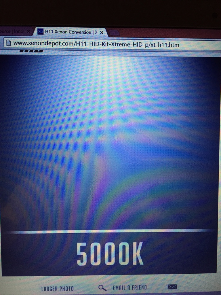

  17. 4rpr15
    4rpr15 Senior Member
    Jul 16, 2015
    1,056
    375
    WI
    Theretrofitsource.com
    Xenondepot.com
    5000k
    6500k - you can tell that there is more light than 5000k
    '15 Prius Persona-Blizzard Pearl
  18. xliderider
    xliderider Senior Member
    Apr 19, 2012
    8,140
    3,280
    Honolulu, HI
    Look at the lumens value in your first image, 3300 is greater than 3100.
    Then look at the lumen rating for the 4300K, which will be higher than the 5000K rating.
