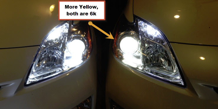

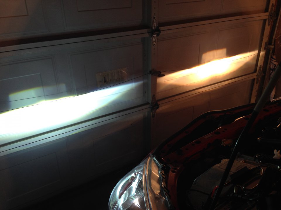

    So I got the replacement bulbs in 2 days which was cool. Hooked the driver side up, fishing the bulb wire through AGAIN!!!:mad::mad::mad::mad::mad:. Looks good with no hot spot and no ground shadows, but I noticed that the replacement bulb was whiter than my old ones. Luckily the when I hooked up the driver side with the new one it was a perfect match. Both were whiter than the first set. Perhaps they shipped my the 4300k the first time and now I really got the 6000k ones. Or it could be their quality control is bad. Here are some pics of what the shorter cables look like and color difference. I do have to say there are very bright and I do like them now, but they could have added a few more inches on the cable with the big transformer, to make installing/replacing bulbs, a lot easier. I can live with a defect on parts, but the ballast???That is a design flaw or is not really meant to go in a Prius in the location XS advertised.
    Hard to tell in the pic, but the old bulb was definitely more yellow and noticeable. Compared with the parking lights which are 5500-6500k.

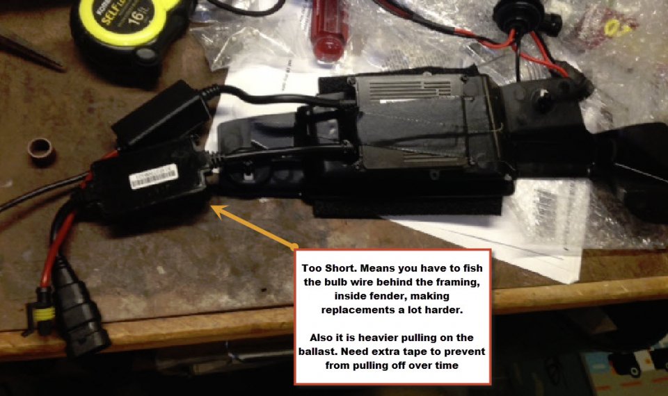

    Here is the STUPID new premium ballast that has the short cable, installation and replacement takes 3-4x longer than it should be and will require more reinforcement because of the dangling ballast.o_O

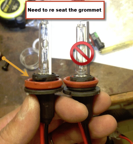

    Lastly, make sure to re-seat the grommet. On both sets, they were off and I had to re-seat the the rubber grommet back into the little grove under the tabs. If you don't it will be way too hard to try to install the bulbs, re-seating them made it a little easier to turn and you don't have to push them in too much.
