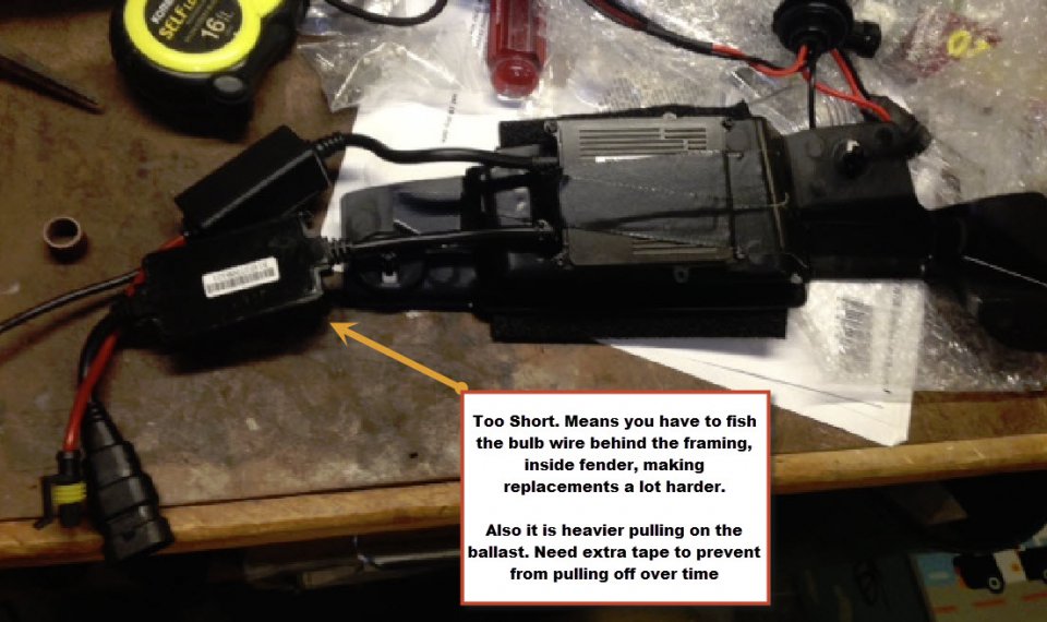

    Agree on the above - I just ordered and installed the XS kit and had the same issue with the cable being too short on the driver side. I ended up zip-tying the ballast to something else b/c I couldn't get it worked in per the video and didn't want bulb replacement to suck. But everything is working fine -- no issues with the bulbs.

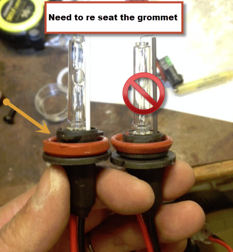

    Installation was straight forward - it was a PITA to get the xenon bulbs to seat correctly before twisting from the 10-12oclock position, but that has to do with the aftermarket rubber sealing grommet. Its fresh so you need to push towards the front of the car to compress the rubber before the 3 nipples on the bulb housing seat into the headlight housing.
    I took an additional step - I read that the ballasts can fall off with the 3m double sided tape during hot summer days, so I just electrical taped and wrapped the ballasts over the plastic side cover just to make sure.
    The included wiring was tight, and if there was about 6" more play from bulb to the connectors would have really made the install more hidden. I ended up mounting all the ballasts regulator plastic boxes with zipties on random holes i found near the headlight perimeter on the vehicle chassis
