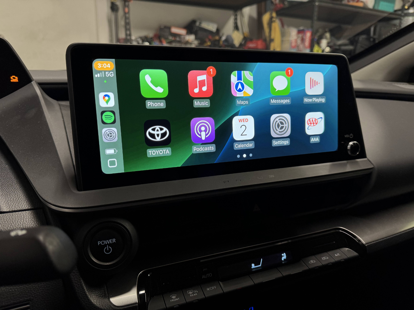

    Hi all,
    I've been watching this thread for a while now and I have some good news to report!
    Using the info Ryan Kim had posted about his experience with the swap, I bought a used XLE 12.3" head unit (86100-47850) off eBay and attempted the install using the existing 8" wiring harness. I'm happy to to say that everything works including the volume knob and volume control on the steering wheel! Just like Ryan predicted, if you have an XLE or LE with the 8" head unit you HAVE to use the 86100-47850 unit so you don't lose control of your volume adjustments due to the internal vs external amplifiers.
    The only thing that is a bit strange is getting connected to Toyota Connected Services. When I start the car, it automatically loads the profile of whoever owned the head unit before me. I can still connect my phone and use Android Auto, but right now there is no way to delete the existing profile and login to my profile. I also can't add an additional profile. Strangely enough however, it seems like all the functions on the Toyota App are still working and reporting my mileage, tire pressure, and door/window status.
    I believe the issue with the Connected Services is that head units are linked to the VIN of the vehicle so this may require a trip to the dealership to go through the VIN verification process and link this new head unit to my car. Not sure if they would even be willing to do that for me. Or maybe I can hard reset the head unit somehow, start fresh, and re-login to my profile? Let me know if any of you have insight towards this!

    I just installed the 12.3" infotainment screen on my 23 LE and everything works great (aside from the Toyota Connected Services, which I'm not interested in anyway, and no profiles show up in settings) Ended up finding one on eBay for around $900.
    I made a simple tutorial for anyone else looking to do the swap on their LE on my website:
    2023 Prius LE 8″ to 12.3″ Screen Swap – Tutorials
    Big thanks to Ryan Kim for doing all the research on this prior.

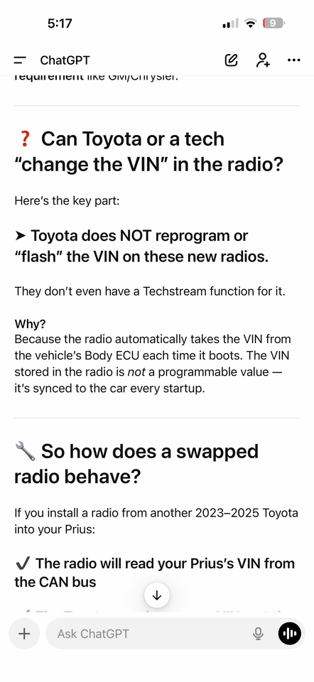

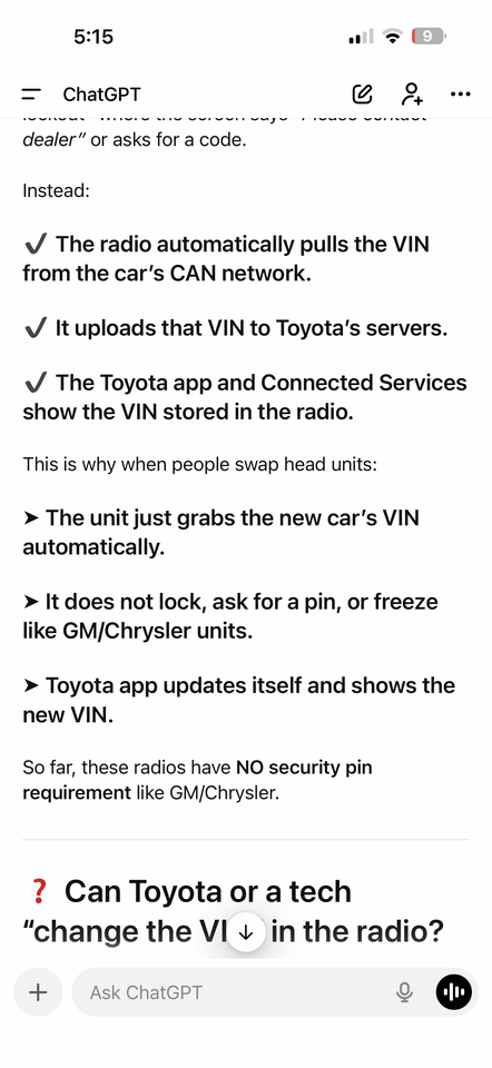

    Has anyone called Toyota to see if they could swap the serial number of the radio? I’m assuming the VIN wouldn’t be an issue, since people have said the VIN stays intact on app. I’m an automotive locksmith and electrician, and most manufacturers lock the radio when you swap it. On Chrysler products you have to enter a password, and on GM you have to flash the BCM to make it work.
    We don’t have that issue here, and the app still shows our same VIN. I just want to make sure Toyota will change the serial number on our Connected Services account. It’s obviously possible since they sell new radios, and they would have to do the same function for replacements. They’re going to make money off people using Connected Services, so assuming the serial number is clean, you’d think it wouldn’t be a big deal to swap it. Would obviously have to because there also has to be a Imei for the SIM card that connects the car to the internet. I assume it’s a built in sim kinda like a eSIM and the serial number change on radio would also activate that eSIM.
    But before I spend all this money, I’d like to know. The range on the factory fob is terrible because Toyota wants people to use the subscription service— that’s why they removed the remote-start buttons on the fob. Plus, it’s hard to remote start with the fob anyway because if you don’t do it exactly right at the right speed, it won’t work. So if you’re sitting in the living room, the range is bad and the timing has to be perfect, which basically pushes you into buying the subscription.
    I have Toyota TIS because I’m a locksmith, but I doubt it would change the serial number on my account. If anything, it would probably update or reset the head unit. If no one can confirm, I guess it’s worth calling Toyota.
    Can anyone confirm whether the VIN changes on the radio itself to match your vehicle’s VIN? I’m not even sure if that’s a thing—I’ve never checked the radio’s “About” settings, and it’s 2 AM. But if there is a VIN in the settings and it doesn’t change automatically, then that’s definitely something that would have to be done via TIS.

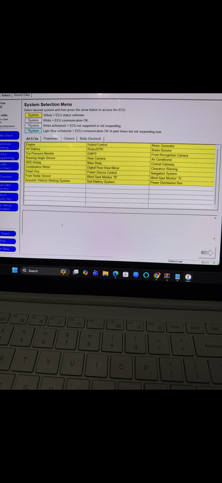

  12. Tony sego
    Tony sego New Member
    Dec 5, 2025
    Louisville ky
    2025 Prius
    I checked this no function my radio will not go into service mode to see vin. There is nothing in TIS maybe I can change radio and simply reset and scan QR code and connected services will work it obviously has some truth to it since the app still shows correct vin. I think I’m gonna try it IMG_0475.png IMG_0473.png
