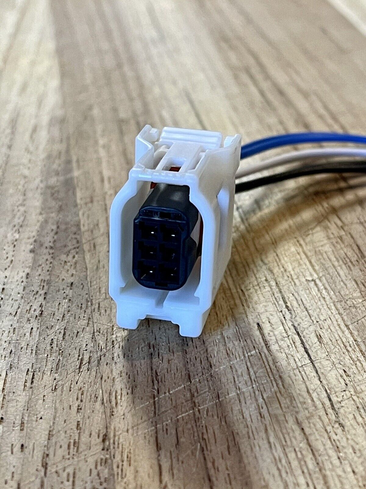

    I recently installed XLE/XSE/Limited headlights on me LE! Everything worked except the turning signals, since the turning signals on the LE is external versus the XLE/XSE/Limited headlights has their turning signal integrated with the DRL boomerangs. upload_2024-3-22_23-10-19.jpeg
    I realized that the LE headlights have 3 pins in the harness, while the XLE/XSE/Limited headlights has a 4th pin. So I bought a new harness and soldered the wires together to get a the turning signal to work! [​IMG]

    What was the cost for the conversion? Curious..

    I found used headlights on eBay going from $600-$1000 each. I spent around $1500 for both. The wiring harness I bought were about $20 each so I spent around $1520 to do this. I'm planning on selling my LE headlights (around $500 each) to recoup some costs.
