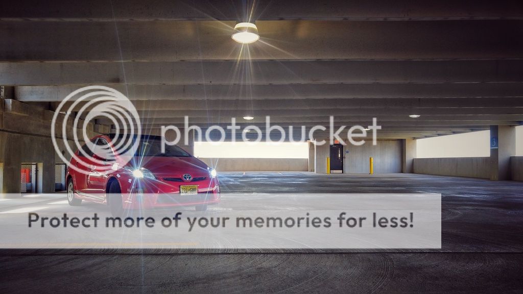

    Went with 6000k. Still need to install the relay.

  18. DRACO
    DRACO Member
    Nov 28, 2015
    362
    78
    Rancho Palos Verdes, California
    2002 Prius
    Those look great :D
