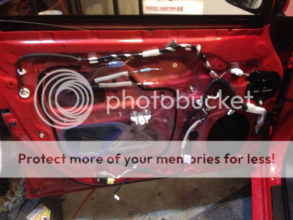

    Here, I've torn off the door skin:

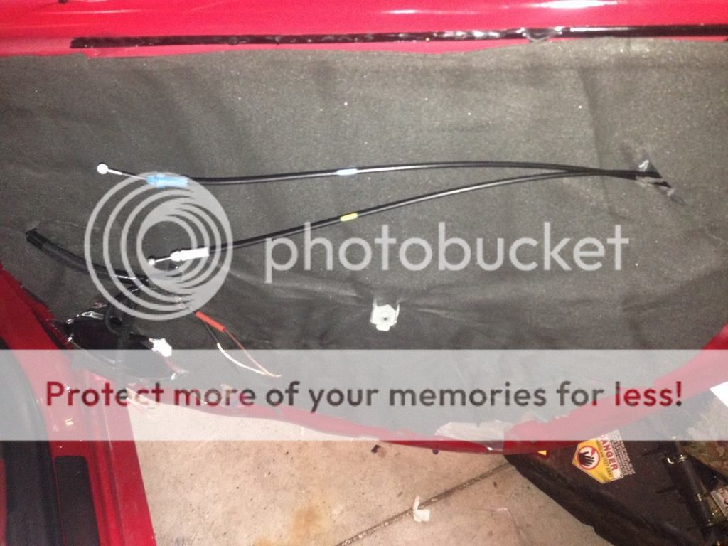

    I then covered the door in raammat....
    ...and then ensolite

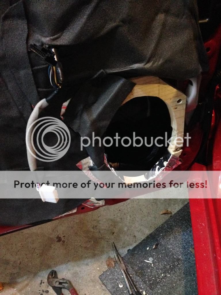

    I quickly noticed that the new speakers were too deep, so I had to build out a ring to hold them out a bit. This is a messy photo, but I did screw the wooden ring into the door with self tapping screws driven into countersunk holes in the ring.

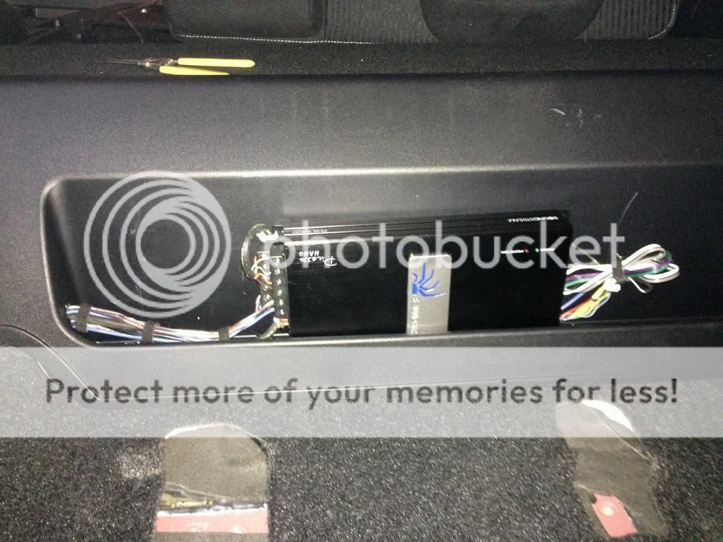

    Now I needed a place to mount the AMP and the useless rear umbrella cubby seemed to be an ideal place. I ripped out the kickplates, the door jamb covers and other various plastic channels to route the wires under.

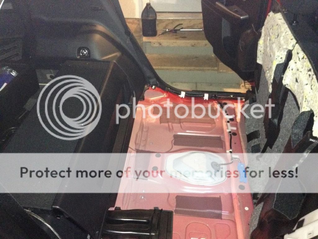

    Since I had leftover raammat and ensolite, I ripped out the rear seats and added material there as well. I don't have a photo of what it looked like after I installed the sound dampener.
    I then popped a hole into the side of the cubby and routed all of the cabled to the cubby and through the hole. I do not yet have the amplified screwed to the plastic but it seems to be doing fine just sitting in the cubby.
