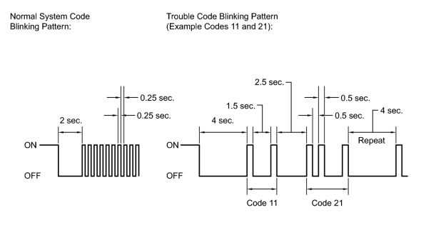

Now observe the blinking patterns of whatever lights are blinking on the dash. If there are multiple codes, they will blink out in ascending order. Each of the indicators may blink out a different code so note that carefully. The two-digit codes obtained correspond to full DTCs that can be looked up in the repair manual.
After the first couple seconds, you might notice some lights blinking just a steady, fast, even on-off, like the drawing on the left below. That pattern is just telling you that ECU doesn't have any issues to tell you about.
On other lights, you can see two-digit codes blinked out, as in the drawing on the right.
