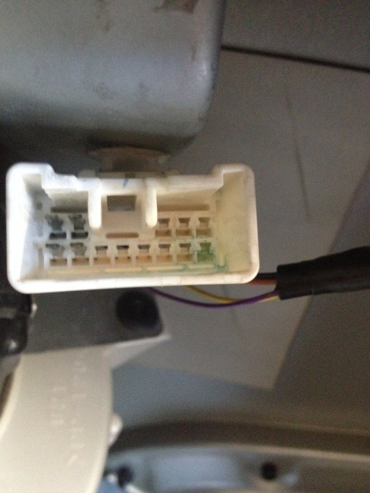

    Ok, after I was frustrated with the online manual and tired of troubleshooting myself I took Ema to my dealer here in NC. Left the car with them late Thursday and they troubleshot and repaired on Friday/Saturday. I picked her up Saturday and have been driving her since without issues.
    Problem was some bad corrosion and shorting in the BM1 Connector for the cooling fan motor and battery control ECU. This connector has like 12 or 14 pins but only 4 are used I think or something like that. They first tried just moving the pins and that didn't work because they found the brown wire ground for the relay was loose and needed to be have a new pin soldered on and re-installed in the connector. After they did this along with moving them to new positions in the connector the PA084 went away and stayed away for good. They were able to operate the cooling fan so everything appears good. I have been driving her for about 200 miles since and the code hasn't returned.

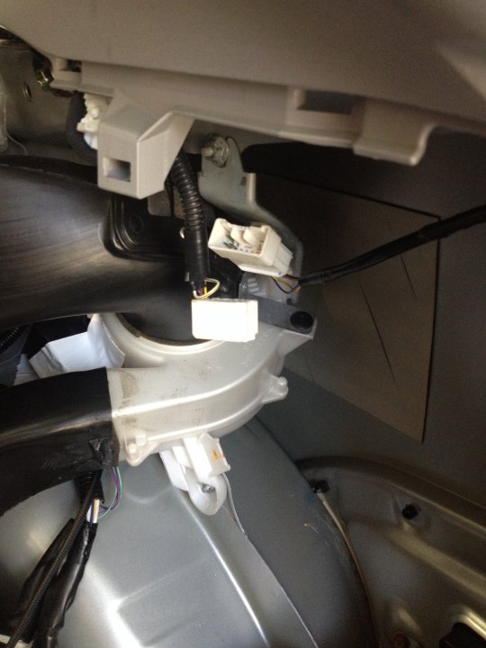

    Here are the photos I promised. The top photo is simply an overview of the BM1 connector point. It is to the right of the cooling fan motor.
    The lower photo is a close-up of the connector itself. The corrosion can be seen on the lower right hand side of the connector. Originally all 4 pins were on the right but I don't remember exactly what locations and I didn't take a picture. The Toyota Tech relocated them to the far left to get away from the corrosion.
    Back to putting the miles on Ema!!!! (y):)(y):)

    I found this discussion very useful because my car has the same symptoms and error codes. I removed the trim today and found the connector with evidence of slight corrosion and water present. Even though my Prius is a 2006 model the connector is different, more pins and a full set of wires so moving the pins is not an option (it is a Japanese specification model as I imported it from Japan to Ireland). I will try and reconnect tomorrow having cleaned the pins as best I can (I presume there is not much I can do about the socket side of the connector except perhaps connect/disconnect it a number of times and hope for the best). I presume the error message in the MFD will not go automatically even if I succeed in removing the corrosion but might I be able to clear it by briefly disconnecting the negative lead on the 12v battery? Also, like the case above, water has lodged at the bottom of the 12V battery well and I am wondering is there a case for drilling a small hole in the well floor to facilitate drainage. Any suggestions on how to stop the water ingress which caused the corrosion would also be welcome.
