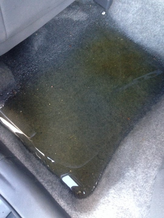

    Who wanted a picture? This was taken early Friday night, after a day without rain! The car was parked at her job for the day, and when she drove it home, this is what the right rear floor looked like. image.jpg

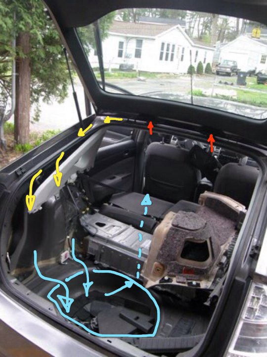

    Here's an update. Someone earlier suggested I check the spare tire well for water build up. I secretly thought he was nuts (sorry), but I figured I would check every lead. Guess what...it was flooded to capacity back there. So I tore everything out to try to find out why it was full of water (after sucking it out with the wet-vac), and to figure out how it was also filling the floor pans. Pulling out the rear seat first, I found water soaked into the bottom of the padding; easily 8 or ten inches higher than floor level. I ripped out all the trim and found water at an even higher level....up in the quarter panels. So, I took to the hose, and started soaking the car on the outside, while all the trim was removed. Here's what I think was going on based on water leak test performed. Refer to photo: there are two grommets, for wires (et al) to pass to the hatch, at the top of the rear deck frame (in red). Water is apparently getting in through them (they are loose fitting, man), channelling down through the frame rails (path in yellow) and literally raining down behind the trim panels, collecting in the wheel well (blue). When enough water had built up around the tire over a long period (she didn't even remember there was a spare in there), it overflowed. With no other place to go, it started running under the rear seat (soaking the padding) toward the front of the car, and spilling over into the floor pans. That's where it sat, soaking into the padding. When utterly saturated, the level on the floor finally got high enough for her to notice pools. What a trip. There is no leak in the front of the car anywhere. All the water came from the damned trunk. SOB. Now; I have to figure out how to fix it. Maybe simple gasket sealer. I tell ya'.....this one was baffling, but I'm fairly certain I solved the mystery. image.jpg
    [email protected] likes this.

    I suggest you have a helper spray water over that area so you can confirm exactly where it is leaking.

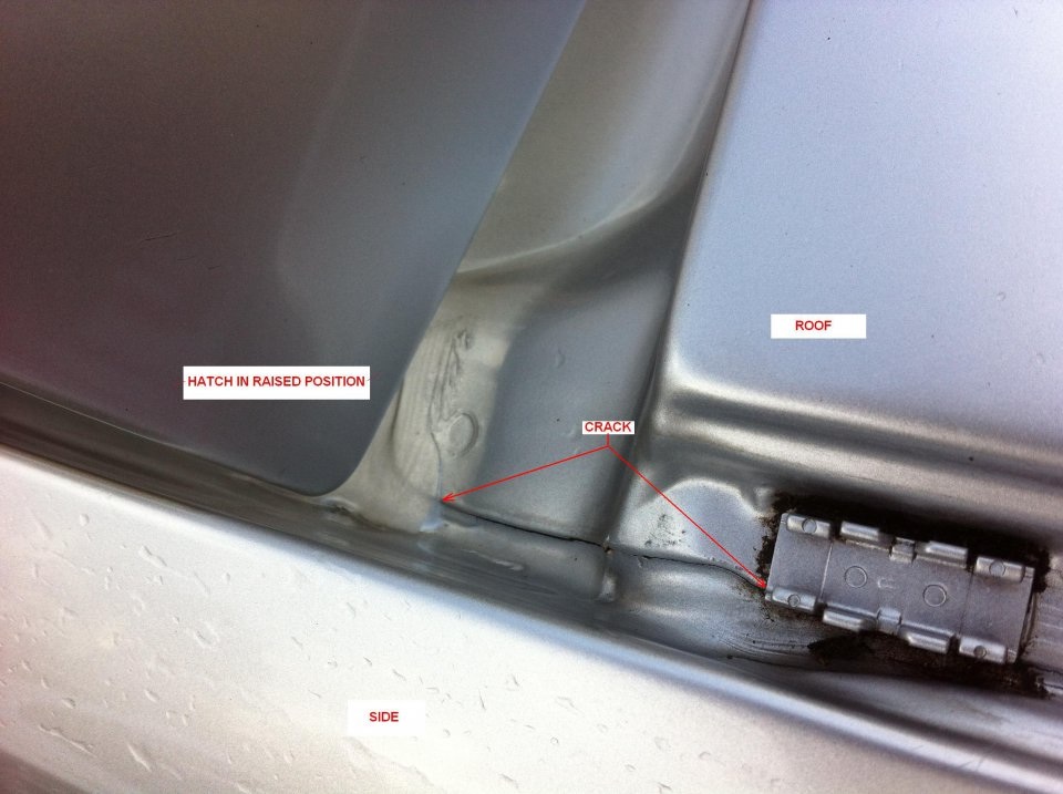

    There have been other recent posts which show that the leak area is actually a crack in the welded seam which is adjacent to or even covered by the black plastic trim strips that run lengthwise along the roof. So I suggest you look at that and determine whether your leak is similar, or from a different area. See post #49 here:

    We did the water spray test. When water was directed at the grommets, it started raining inside the car. All the weatherstripping and body seams are solid....no cracks or splits of any kind. And the grommets are so loose that when I gave one a wiggle it popped out of its hole. I thought I broke it, but it dropped right back it. It's just loose. The bolt holes that hold on the rear hatch pistons are also suspect, but it's impossible to hose down one of these areas without soaking the other. Oh, yeah...I sucked all the water out of the battery tray too.

    I checked out that other thread, and went back to check mine according to this picture he posted. On both sides of the roof, there is a black rubber strip that run from front to back. At the rear most point, where this rubber clips on, there is an observable, hairline crack - so fine I missed it the first time I checked. Mine are not so obvious as the one in the attached photo, but I can see them. Black RTV to the rescue tomorrow. Fill those cracks up, and glue down the grommets. Thanks for that tip. image.jpg
