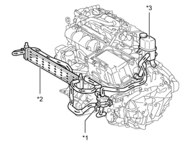

    The ECU -inverter loop contains coolant that dissipates heat from the transaxle.
    The transaxle fill plug does not need a magnet.
    The drain plug is the one that needs a magnet. It takes all of the steel and iron particles worn off of the gears and other metal parts of he transaxle. Otherwise, these friction particles circulate with the transaxle fluid and increase wear in the gears and other moving parts.
    Hope this 'splains it.
