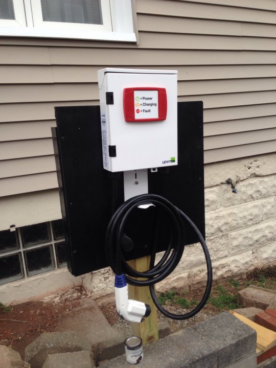

    Here's a picture of my charge Station on the edge of my driveway. Been installed now over a year and still looks as the day it was installed. Been rained on , covered with snow and never a problem and no one is going to steal it The 220 volts of juice will see to that

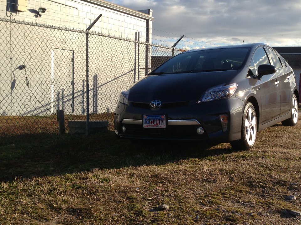

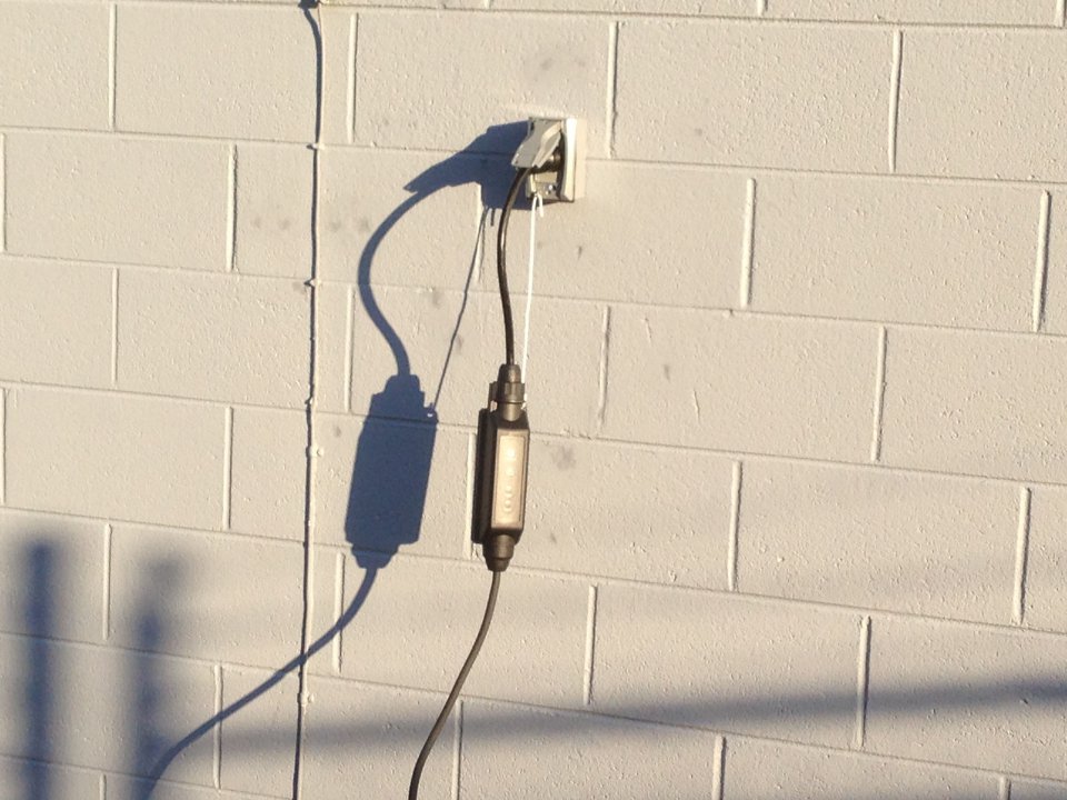

    :)This is my outdoor Level 2 charging setup at work. Including the cost of the modified EVSE, no more than $450. I was able to reroute a unused 220v line which saved on cost.
    SAronian and Chazz8 like this.
