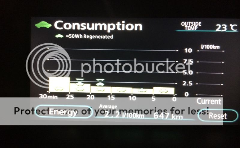

    im still on the second tank fillup since getting my plug in up and running.
    was getting good numbers this tank averaging 2.3L / 100km.
    tonight when i got home from work, and i checked the consumption screen, i was somewhat shocked to see 2.2L / 100km ! that's 106.9MPG US (over 647KM and just over 1/3 of the tank) 3 pips have disappeared from full.
    to say im happy is the greatest understatement i have ever made :)
    conditions have been all city, between 50 and 70kmh, some small hills (as is evidenced by the regen)
    temperatures here are in the mid 20's (c) to low 30's. daily commute is 38km round trip to work and back.
    i don't think it can get better than this (MPG wise) so i thought i would post this washed out phone picture now. i was planning to do this at the fill up point in about 3 more weeks.
    the first bar on the MFD at the 30 minute mark shows where i started a cold engine and left work.
    so you can see the entire commute (one way, work to home). the car had been parked in the lot at work for 9 hrs before i left. im using about 3.5kwh per day from the wall.
    i am kind of curious as to what MPG / L/100km other plug in users are seeing ?

    yeah, i think i will be able to get 6 weeks of commuting to work and back and other neighborhood trips before i have to fill up again.
    im now at 750km on this tank and still averaging 2.2L / 100km.
    still 2 pips above half showing on the fuel gauge too :)
    most days i consume about 3.7kwh from the wall and i have about 25% remaining on the SOC meter (for the plug in system) so allowing for some losses due to efficiency of chargers etc, i assume im using about 3kwh per day give or take.
    my charger is a 2.5kw, 25A unit, so i can fully charge in around 3.5 hrs.
    my economy has improved markedly since i learned some of the secrets of the G2 Prius....
    like how it seems counter intuitive to wait until the engine cuts out before driving off from a cold start...
    if i wait till it cuts, and the coolant temp is around 48c, i get WAY better economy in the first 5 minute segment, than if i just drive off straight after starting up.
    add to that im not in a big a rush to get anyplace anymore at my age, im slowing down (my young hoon days are LONG past :) ), so im happy to sit a few km under the limit and just use warp stealth mode more often.
