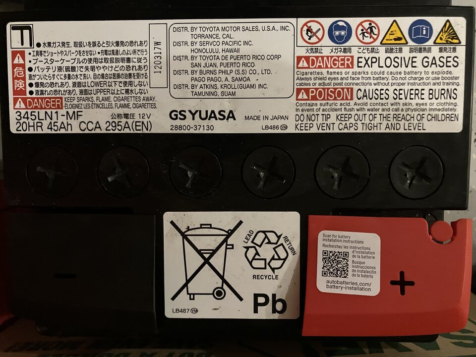

    Here is the battery, if the number on the top is the date code, then it’s December 03, 2017.

    Voltmeter says 11.8V when sitting but I don’t think the battery has the CCA of a new one, it appears to be 8-9 years old.

    If that date code is correct, I think you got your money's worth out of the original battery. Especially since the Gen 4 put the 12V battery back in the engine compartment. I think for longevity, it's better to have it where my Gen 2 and Gen 3 had it, by the tail light (other than having to open the rear hatch with a dead battery when you actually need to replace it).
