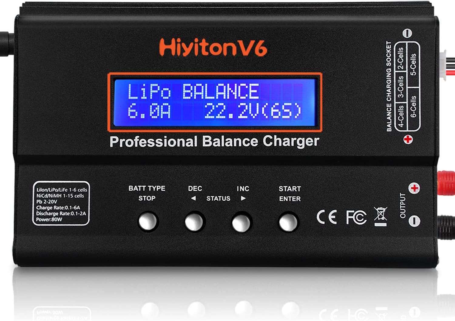

    I absolutely wanna make sure it’s the HV battery before I buy a new one. I replaced couple of cells last time which were 6.2volt with 7.2volt, is that low as well? All other cells were above 8volts. Red triangle showed up again after 5 miles.

    When replacing cells, you need to charge the "new" cells to the same voltage as the other cells in your battery or the ECU will flag an unbalanced battery.

    ... and the "new" modules need to be of the same general capacity as the existing old modules.

    How do I charge them?

    You use a hobby battery charger - about $40

    Thanks, after I charge them do I need to discharge them? Do I have to do this cycle few times? Also how would I discharge them? Is through the same equipment?

    And at the end of the day a bunch of diy leaves you with an unreliable battery and no warranty.
