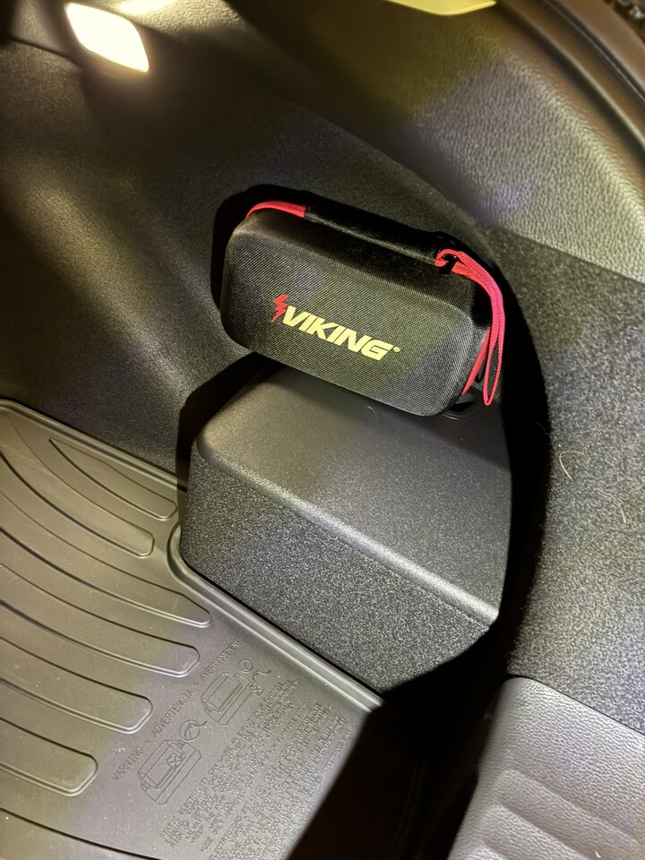

    Velcro sticks to the trunk lining material. It's not as fuzzy as some other linings I have experience with, but it still sticks.
    I put a big strip of velcro on the back of the Harbor Freight Viking jump pack and put it on top of the battery lid, up against the liner.
    It's out of the way, easily removed for battery access or actual use. If too easily removed, lol, I might stick velcro to the top of the battery case, but it's brand new...

    You many want to move that up front; perhaps under the seat. If your battery is really dead; you may not be able to pop the trunk and have to crawl back there to retrieve it.
    As long as the car is parked in your garage, the cold may not effect it's use. Just remember that those lithium batteries likes to be warm too.

    Not much room under the seat. Plus doesn't Toyota frown on putting stuff under the seats?
    If I managed to unlock the driver door with the mechanical key, would I be able to open the side passenger rear door with the mechanical button? I'm thinking not.
    edit: Still, I could open the passenger door from the inside, then open the rear passenger side door with the inside handle while standing outside, then make the reach. No crawling.

    Was thinking similarly. Still, in a bad front end collision, it might become airborne. Under the seat would be better in that regard. And less prone to thieves' interest.
