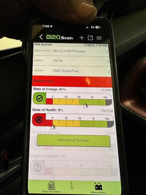

    I’m not mechanically inclined and looking for a dummy-proof way to maintain my 12V battery when I’m gone for weeks. I’ve read several posts here and many are too technical for me. Mostly, I’m nervous about leaving a battery maintainer on my car for weeks. I’m even nervous about connecting the cables correctly to the battery (since I’m not mechanically inclined).
    I’ve been gone a lot this past year (my father and brother had and continue to have health issues). First two trips (6 weeks and 3 weeks) I came home, and the car started fine. After third trip (6 weeks), the battery was dead in the garage. (on the 6-week trips, a friend came and drove the car around the block once). AAA jumped it on the fuse box and used a battery monitor and said the 12V needed to be replaced. It’s still under warranty, but the Toyota dealer said they needed to first charge it and see if it would hold a charge. It did, so they wouldn’t replace it under warranty. That was a month ago and it’s been fine.
    Is there a dummy-proof way to avoid this? The Toyota guy said to have someone drive it for a ½ hour every week, which feels like a big ask. He also said there are devices (trickle chargers? Battery maintainers?) As we talked, he said they even installed one permanently for a customer and she just connects some cables vs. clamping anything onto the fuse box or 12V battery leads (which I’d rather not do when I’m rushing to a flight). I may not have the wording right on this, but you get the idea. But even this doesn’t seem super safe. Any thoughts? Thanks in advance for your help.

    Hi everyone, thanks for your replies. I appreciate it. I am procrastinating on dealing with this, as you can probably tell. But I did talk to a friend who owns an old British sportscar that she keeps charged using the NOCO Genius 10. She never worries about leaving it plugged in, so apparently, I'm the only one. lol. Anyway, here are my latest thoughts:
    0) get up to speed on the parasitic drain and do what's needed to reduce this drain
    1) even while not traveling, test my 12-battery level and charge periodically. (I don't drive a lot)
    2) a day or two before a long trip, charge 12V.
    3) while gone, ask a friend to drive maybe once every 2 weeks for 1/2 hour
    4) try not to be gone for 6+ weeks
    Does this seem reasonable? I had taken those other trips last summer (6 weeks and 3 weeks) without problems. It was only the final 6-week trip (Oct/Nov) where the car wouldn't start.
    I suspect in time, I may be less worried about leaving the battery maintainer on while I'm out of town, but this could be a good start. Thoughts? Thanks for your help.

    Now that you drew down your battery, requiring a jump, It won't have the same capacity that it use to have. Every time a heavy draw-down happens, your chipping away at the battery's' longevity.
    You've got a solid plan in place; but leaving the 12V battery plugged into a "smart" automatic battery charger; would be easier on all parties involved.
