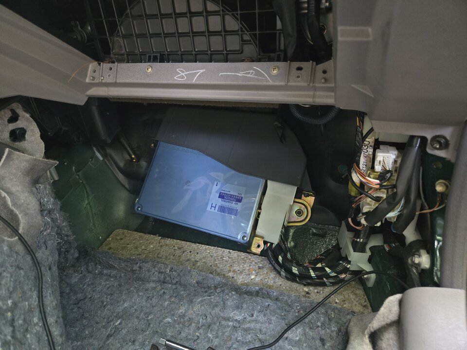

    Is that the module attached to the battery or the one on the dashboard behind the glove compartment? Or could it be either/both?
    If I can definitively trace it to one or the other I can look into getting a replacement.
  5. ChapmanF
    28,558
    18,898
    It's under the carpet beneath the passenger's feet.

    So it looks like this is the unit in question. I see multiple replacements by the year and part number, ranging from around $40 on eBay (https://www.ebay.com/itm/151041560601) to $6-900 from Toyota.
    The service manual has a lengthy section about connecting an external battery system during programming, which I take to mean I need to hook the 12v battery to a maintainer and make sure it doesn't drop too low. I have some chunky 13.8v supplies from ham radio that should do nicely.
    What I am wondering is CAN I even program this using Techstream or do I need a valid Toyota TIS account to pull the required calibration information?

    I think you should be able to. The section in the repair manual about replacing it doesn't have a lot of special instructions. You should probably also review the section on the chip key/immobilizer, because I seem to remember a special procedure for a transponder key ECU and HV ECU to introduce themselves to one another when either one is replaced. I didn't see those instructions yesterday in the "replace HV ECU" section, so probably they're in the other section. But probably they apply when either ECU is replaced.
    The HV ECU might want the VIN to be programmed. I've never tried doing that but I might have seen something in Techstream for it. Of course a new ECU probably comes out of the box wanting its VIN programmed and a used one may already think it knows its VIN. I don't know if that complicates the programming any, but I'm sure people have reported putting in used HV ECUs here.

    I went ahead and ordered the correct module, I will try putting it in and programming with Techstream when it arrives later this week. It is a scrap pull, but that is better than $900 from Toyota and for $40 I figure might as well. There is a worst case scenario: I could desolder the EEPROM from the old one and move it to the new one. It helps that I'm an electronics repair technician.
    In the meantime I might try replacing all the electrolytic capacitors. Certainly can't hurt.
