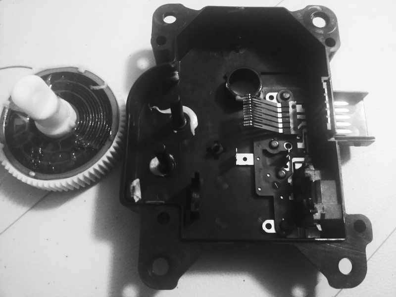

  6. bobofky
    bobofky Member
    Jun 18, 2007
    107
    One of my 2001 Priuses started blowing heat into the cabin with no regard to the settings of controls. My mechanic discovered that the shaft of the Vane Actuator Motor that controls the direction of airflow through the A/C vent or the Heat Vent had broken so that the vane was staying with the heat direction. I have a 2001 Prius Parts car and want to take the Vane Actuator Motor out to replace the broken one. I am not able to remove the electrical plug from the motor. Does anyone know the secret for disconnecting that plug?
  7. ChapmanF
    28,638
    18,959
    You mean this guy?
    I don't remember any special secret; I think it was squeeze-the-squeezy-bit and pull, like most of the connectors in the car....
    It might be worthwhile to check by hand that the vane moves easily through its full range of motion, before installing a replacement actuator—just in case there was a reason the last one snapped its shaft.
