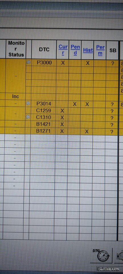

    No red triangle... But the usual suspects of DTC are back. Looks like i need to address the battery. However, surprisingly nothing appears for Engine...but only as INC. So its not complete? I think i need to check fuses. I already mentioned all fluids are great.

    • P3000 means the hybrid control ECU heard from the hybrid vehicle (HV) battery ECU that it has a problem.
    • C1259 means the skid control ECU heard from the hybrid vehicle (HV) battery ECU that it has a problem.
    • C1310 means the skid control ECU heard from the hybrid vehicle (HV) battery ECU that it has a problem. It prohibits Enhanced VSC operation and a part of ECB control by the fail-safe function.
    • B1421 is a binary switch (i.e. indicates on/off) and is not a problem unless you read this code in bright sunlight. Its normal function is to tell you that it sees bright sunlight or not, and if that lines up with what happened, there is nothing wrong.
    The DTC to focus on is:
    • P3014 means battery block 4 becomes weak.
    Followed by:
    I hope that helps.

    Thank you, I am aware of the faults that appeared, especially the cluster guage capacitor failure it was never upgraded.

    What dolj is trying to say in post 22 is most of the codes in the photo are only there because of the P3000 and P3014. Those are the ones you need to focus on. Fix block 4 in the HV battery and the other 'associated' codes will clear. Your dash is no big deal, you've adapted and overcome it by logging fill-ups. Block 4 failing is going to make your life tougher the longer it goes, because the bad module is only going to continue getting worse.

    There are no codes that implicate the "brake booster"
    That was not what was being said in my post that you quoted. The hybrid control and Enhanced VSC ECUs are merely acknowledging that they are aware that the battery ECU has a problem and will tailor their function to suit.
