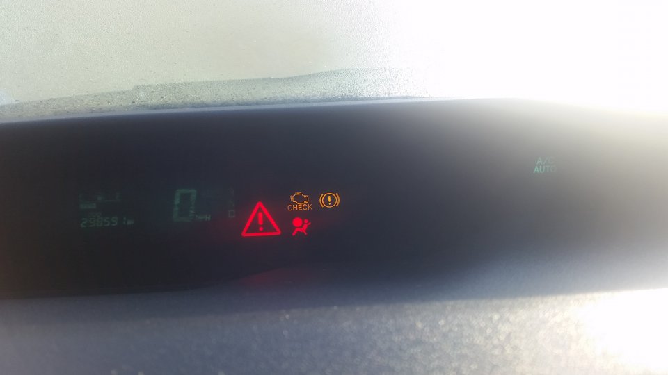

    Thank you for the info. We had our oil change done already. But still it lits. I will try to manually reset it today. How can i find the diagnostic code?
    This is what shows up on my dashboard when i start the engine
    I manually reset the odometer. When i turn it on maitenance reqd still lits up but now it disappeard immediately. And its not blinking anymore. Did i do it right?
