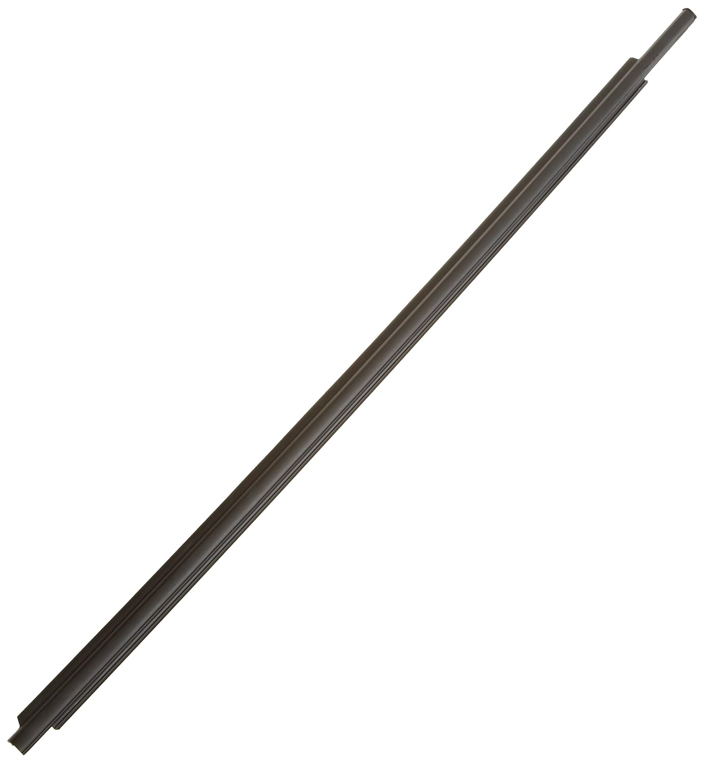

    Pictures never made it through, but from your description that could be the correct part.
    Does it look like this ?
    Gstatus64 and Raytheeagle like this.

    If it's what @SFO pictures, that's an easy part to replace. I've done several of them. Hardest part is cleaning off the goo they leave on the glass when the felt comes off and you run the windows up & down.

    Yes that's the part.
