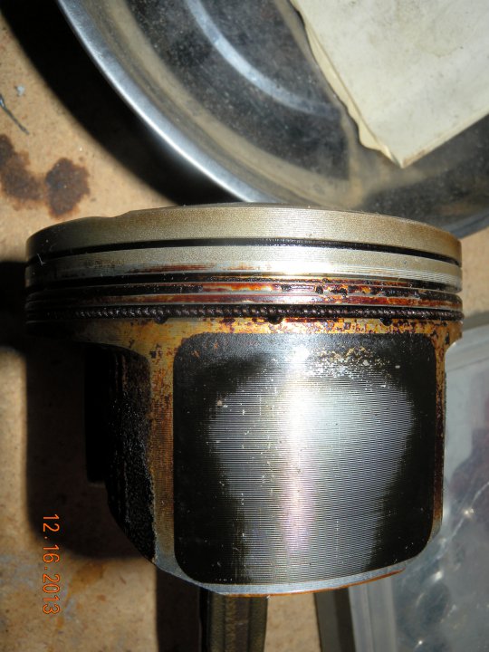

    This engine still has the crosshatch pattern on the cylinder walls!!! This means very little wear.
    I would only clean pistons, put new rings in, new seals and put it together.

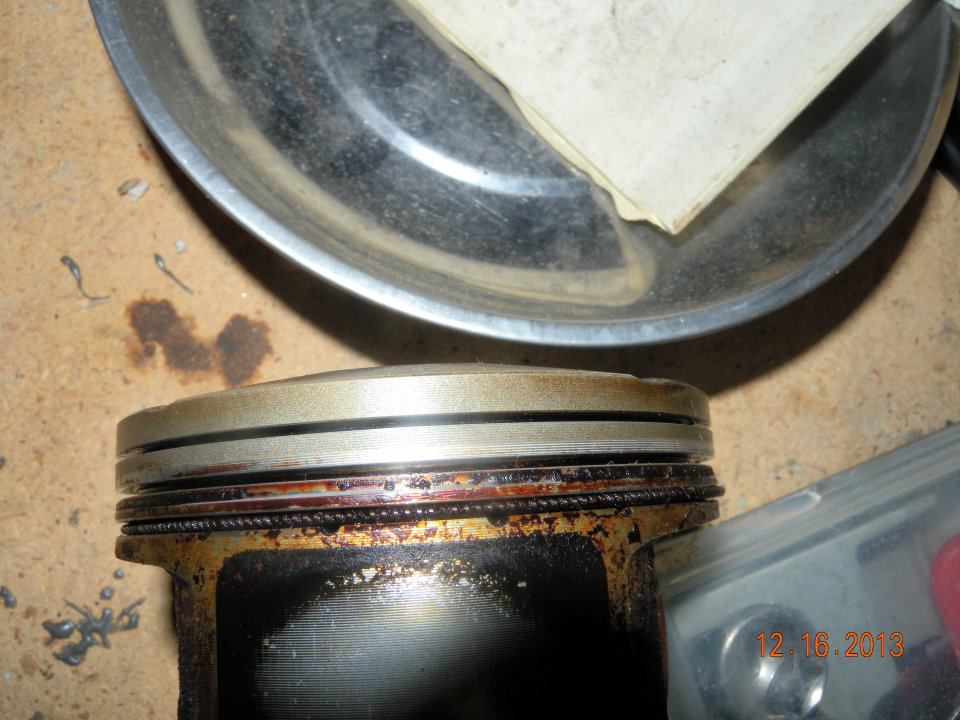

    Many thanks for posting the pictures of pistons. A question for you. Did you see it they were oil holes in the oil control ring grooves? How many holes per piston? Were they plugged up? The reason I'm asking is most of recent Toyota problems with oil consumption boils down to too few oil holes that tend to plug in and foul oil control rings. That was also a problem in Saturns.
    See this picture for location of the holes:

  12. johnjohnchu
    johnjohnchu Active Member
    Jan 12, 2008
    211
    104
    Also, my mechanic told me that he tested the old disassembled engine by filling the cylinders full of transmission fluid. All of the fluid leaked out within 2 to 4 hours for each of the cylinders.
    According to my mechanic, that is bad. It implies insufficient engine cylinder seal.

    There are 8 drainback holes per piston. They are all very dirty, perhaps not completely plugged up. Did not see any drainback notch.
