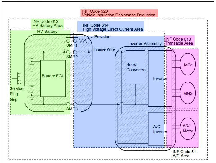

    Thank You! Okay so in my picture, the terminal towards the front of the car read .7 but the terminal towards the back of the car read 22.1
    So with that reading of 22.1 does that mean I have a cell leaking that needs to be replaced?

    Oh, I just looked more closely at your photo. You were measuring on the car side of the main relays.
    Was the car in READY at the time? If not, those relays are off. To be measuring the battery proper, you would put your test leads (carefully) on the battery-side terminals of those relays instead (the ones in your photo just to the left of the ones you drew the arrows for).
    Your 22 volt reading on the car side of SMR2 is kind of interesting ... I'll reserve judgment on it until we also see the battery side.
    You see what's going on with the three relays in this picture. (SMR1 is the smaller separate one in your photo, that is sort of wired to both terminals of SMR2 but with that ceramic resistor in between.) According to your arrows, you were measuring on the 'blue' side of SMR2 and SMR3.
