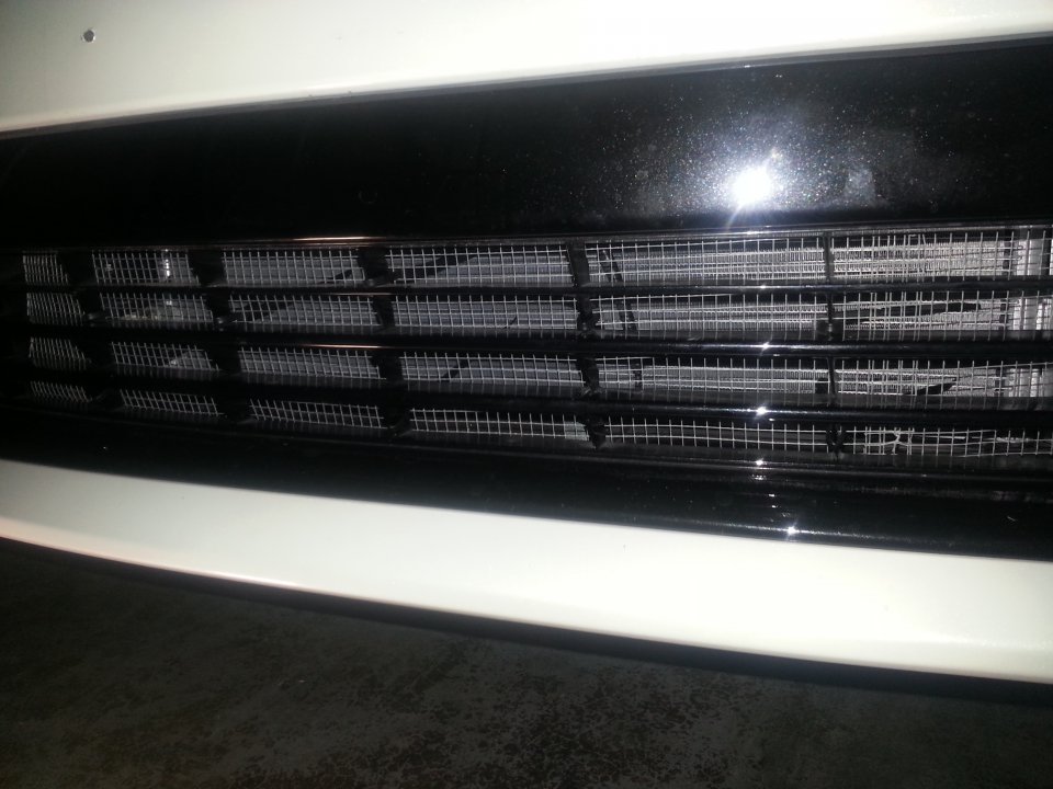

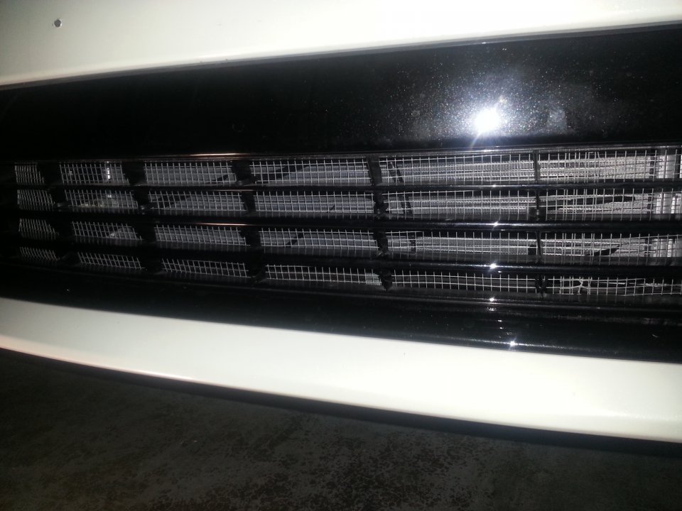

    If the A/C degraded over time, that's one thing. However, if it spontaneously stops blowing cold you might have taken a rock into your condenser (which is the first thing you see looking into the front of your grille -> that's not the radiator).
    My wife's did just that, and after having the condenser replaced I filled in all of the front holes with 1/4" stainless chickenwire. Some images from a prior thread:
    Is A/C failure common? | PriusChat
