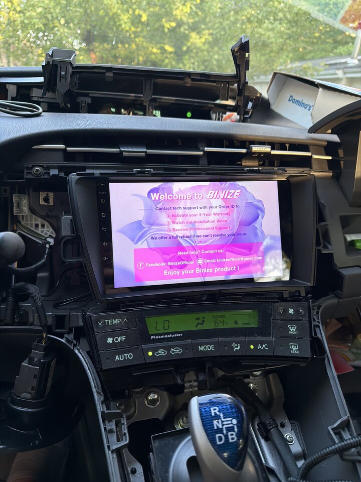

    I’m hoping someone has run into this before.
    I have a 2010 Toyota Prius with the factory JBL audio system and factory backup camera. I recently installed a Binize Android head unit (Android 15, MT8163 platform).
    The head unit is working well overall:
    Powers on normally
    Sound works
    Steering wheel controls work
    CAN bus appears to be communicating
    CAN setting currently shows: Toyota → PRIUS_XP01
    To retain the factory backup camera, I purchased a Toyota camera adapter that converts the factory camera connector to an RCA plug and connected it to the camera input on the Binize unit.
    The problem is that when I shift into Reverse, absolutely nothing happens. The radio does not switch to a camera screen, does not show a black screen, and does not display “No Signal.” It simply stays on whatever screen or app I was already using.
    Because of that, I’m wondering if the head unit isn’t receiving the reverse signal at all rather than there being an issue with the camera itself.

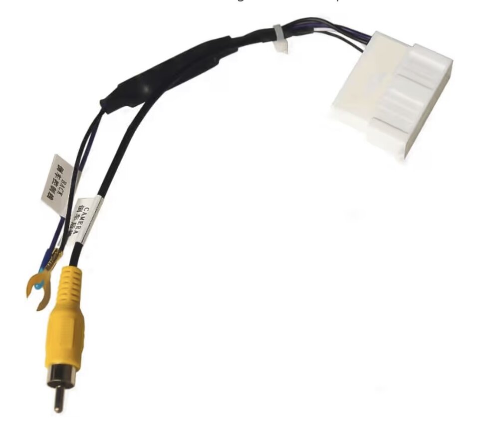

    There are 2 additional wires on the adapter. Did you properly wire them? Or did you just connect the RCA plug to your HU?

    You need to buy this harness on Amazon.
    I have the system and only this kind will work. Screenshot_2026-07-29-17-57-16.jpeg
