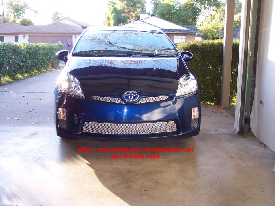

    And if it was a punctured condenser coil, consider this mod. I've been very happy with the protection it has provided so far:
    Rebound, edthefox5 and bisco like this.

    Actually I thought about your thread but couldn't remember your name as you had a similar experience iirc.
    Excellent work. Looks incredible like there's a turbo in there.

    Thanks edthefox5 - here's my original thread on the mod:
    Grillcraft installation - protection from stones | PriusChat
  17. edthefox5
    edthefox5 Senior Member
    Jul 25, 2007
    10,096
    4,840
    Clearwater, Florida
    Thanks for the site. Alas no G2. I would buy it if it did. Huge improvement on the looks. Highly recommend for G3.
    Does not take much of a rock at 70mph's to ding the condenser.
    phoenixgreg likes this.
