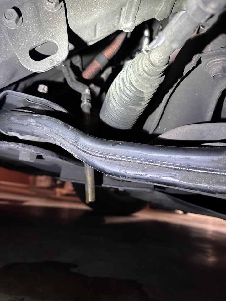

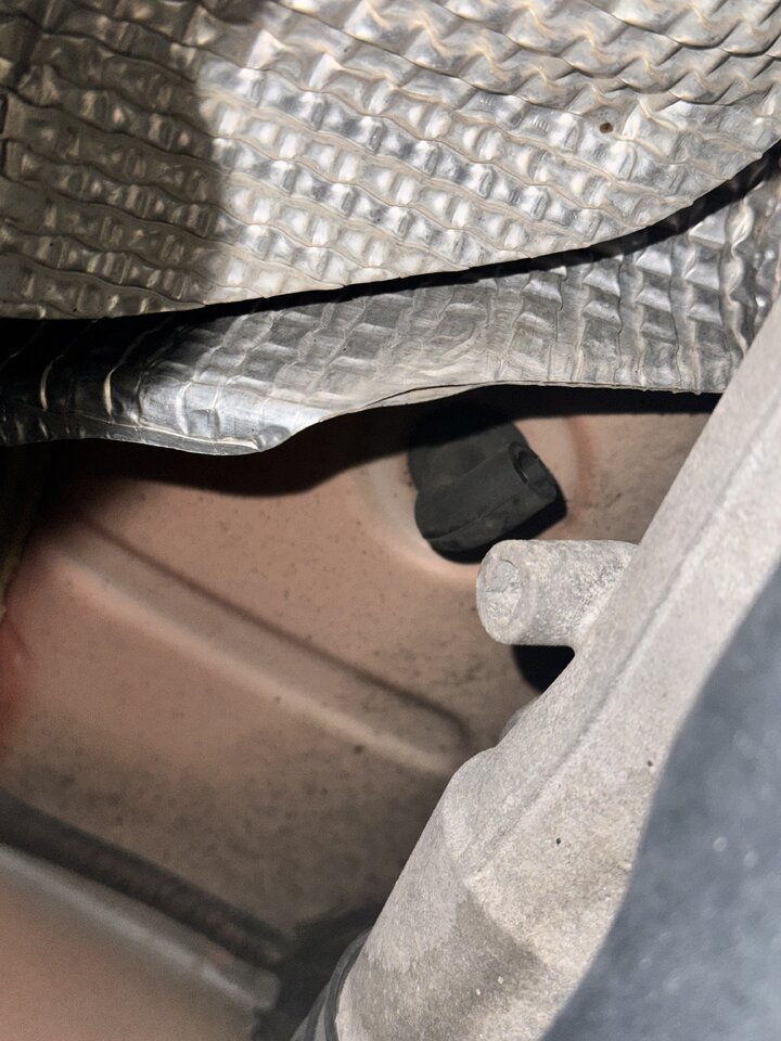

    Okay, so I was able to raise it better and get under it. If anyone can confirm, this is the A/C evaporator drain tube, correct?
  8. bisco
    115,387
    52,820
    i think so, is there a drain for the front vent intake grids as well?
  9. Sosa
    Sosa Junior Member
    Apr 16, 2017
    Utah Valley, Utah, USA
    Not that I was able to find, although I do think it's the same drain if I read it correctly.

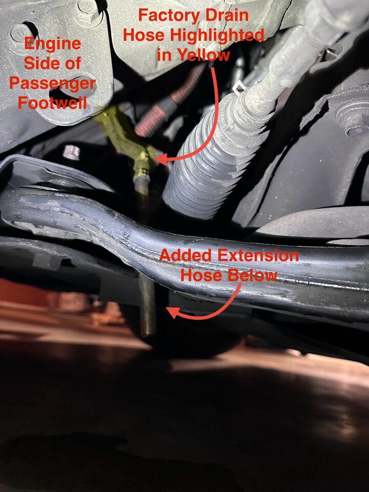

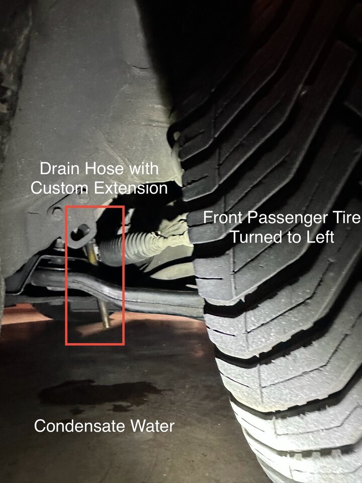

    Run the ac on max cool for a few minutes and you will see water dripping out. It is behind the passenger's side inner wheel well close to the firewall.
    Without a shop lift you need to jack up the front passenger side or the whole front end. I used to remove the front passenger's wheel to access the drain hose and then inject the foam cleaner into the evaporator. After a few minutes the foam liquifies and drains out. You then repeat. After a few cans over a two year span the mold does not return.
    Early on I added the drain hose extension which allows access on the ground with the wheel turned as shown. I can reach in and pull the hose toward me to inject foam.
