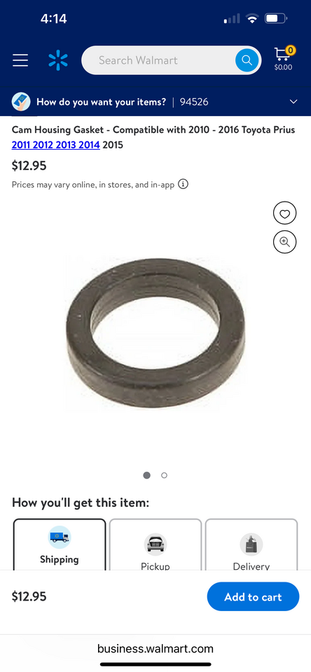

    The only one I’m struggling to find is the timing chain tensioner gasket. I’m guessing the permatex wouldn’t work here? I’ll check Toyotas website to see if I can get one there.
  6. Zack Jones
    Zack Jones New Member
    Jul 28, 2025
    What a great resource, thank you!

    yeah don’t use rtv for that gasket, Toyota sell the metal gasket for it.
    here’s the link for one
    https://amzn.to/4l4HOSd

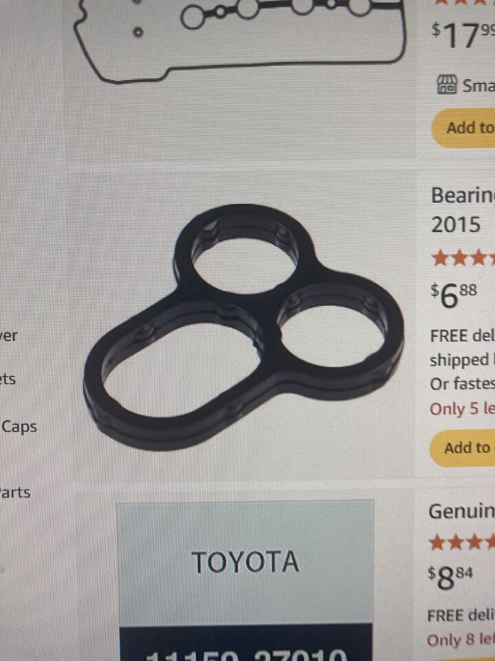

    I’m also struggling to find some of the other gaskets. I’ve already chased the felpro head gasket, not the kit and am struggling to find the pieces not as a kit. Would you think the metric o ring set from harbor freight would work? Is this also the other gasket you were speaking of?

    yes, that 3 hole gasket is for the top of the cam shaft housing, and this one
    https://share.google/qzliV20l3NLEgbWQc
    The o-ring kit I believe would work for the side of the cylinder head, engine block and maybe the oil filter housing, you just gotta check the size for those.
