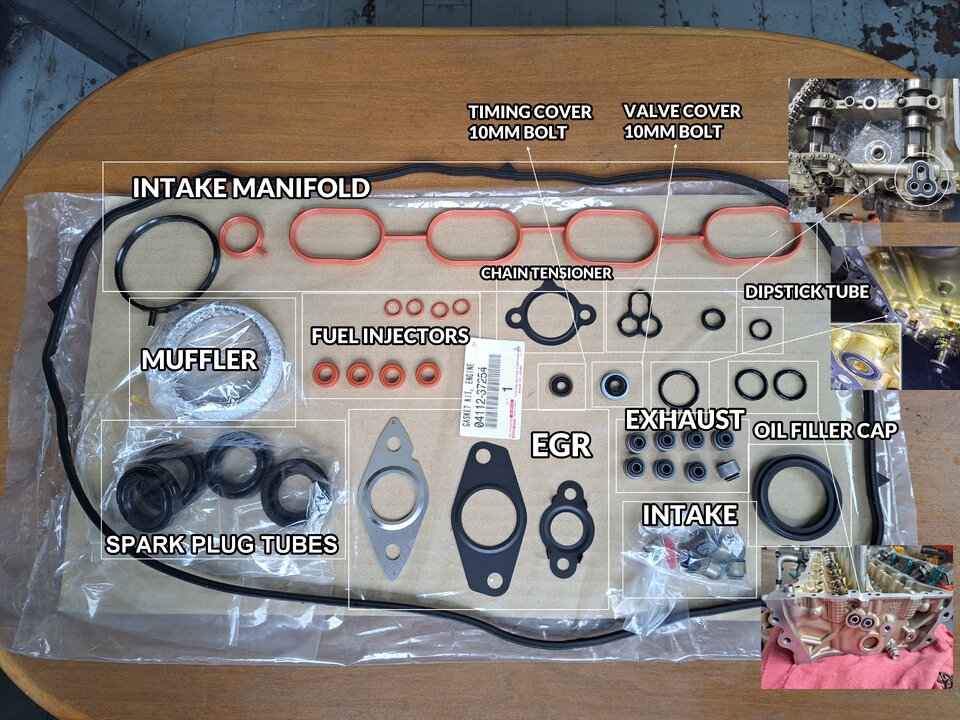

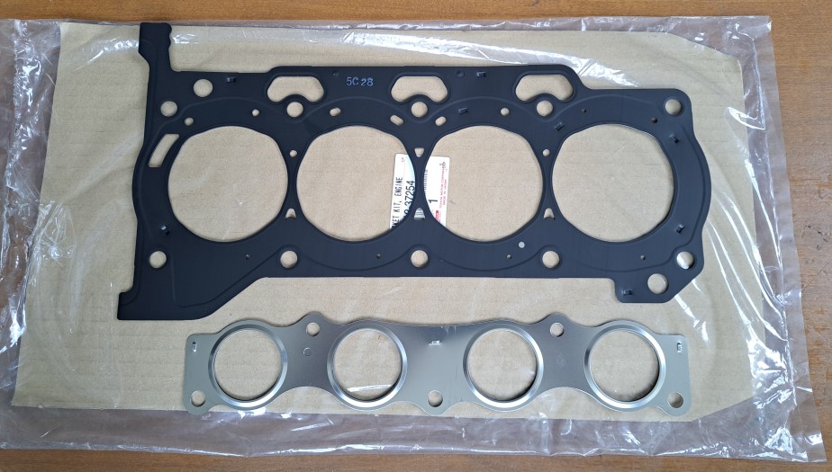

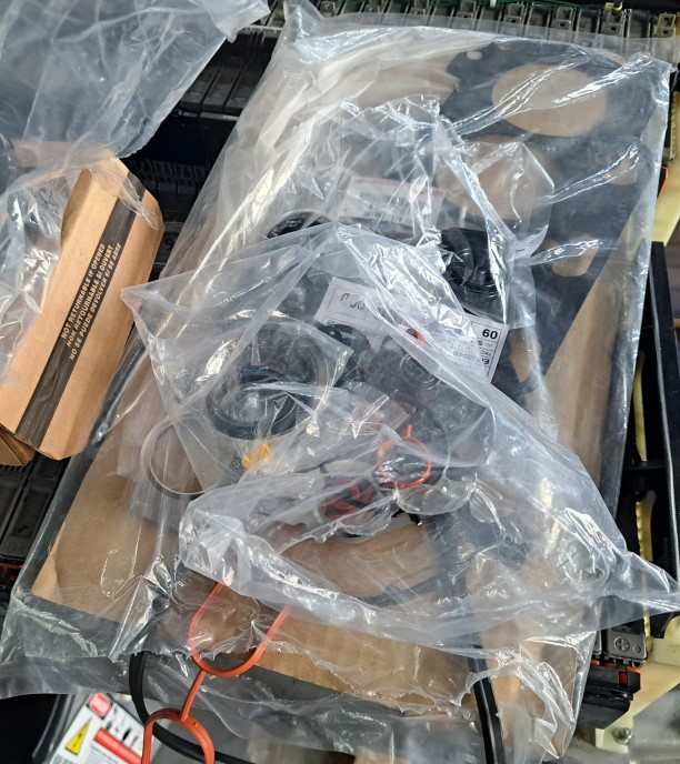

    I tried to find on this website what this set looks like and couldn't find it.
    Engine Cylinder Head Gasket Set - Toyota (04112-37254)
    There are also questions about some of the o-rings from this kit. It is not clear where they are placed.
    Strangely, this kit doesn't come with 2 o-rings for the oil filter housing.
    They could have packed it better. The the exhaust manifold gasket lies on the head gasket.
    #30 Carall, Jul 20, 2025

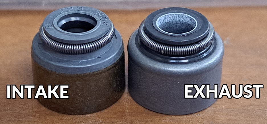

  12. Mendel Leisk
    61,492
    42,310
    You're in luck, @NutzAboutBolts has just posted a head gasket video, starts off part 2 with a thorough explanation of the Toyota gasket kit parts: here:
    Nutz About Bolts Prius Maintenance Videos | Page 28 | PriusChat
    Also mentions several that were not included, which he purchased separately.
    I've always gone back to the kit part no in the attached, when the question comes up, not sure if it's still the latest.
    Carall and NutzAboutBolts like this.

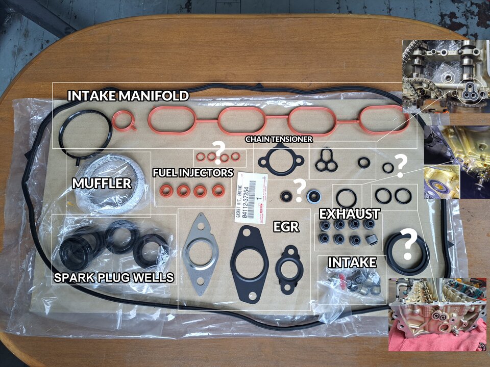

  13. ASRDogman
    ASRDogman Senior Member
    May 29, 2018
    8,055
    4,083
    The "?" on the right of the part number sticker, I believe one goes in the front of timing cover,
    and the other goes on the head under the cam shafts, or on the valve cover. You have to look
    closely, because it's small, easily missed. I forget where the left "?" ones goes, sorry. It's bee a year...

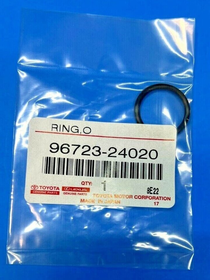

    Some updates.
    The part number for the O-Rings, Oil Filter Bracket 96723-24020
    adrtho4 and Mendel Leisk like this.

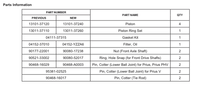

  15. Mendel Leisk
    61,492
    42,310
    There seem to be at least two gasket kits, the first is from the oil consumption mitigation TSP I posted earlier, and the second what you’ve posted on table top, plus title/description from Toyota USA parts site, more head-centric:
    Engine Overhaul Gasket Kit:
    04111-37325
    Engine Valve Grind Gasket Kit
    04112-37254
    #35 Mendel Leisk, Jul 21, 2025

  17. Mendel Leisk
    61,492
    42,310
    Apologies, should be 04111-37315. Screen grab from the TSB I posted:
    that’s one fantastic picture you’ve posted btw, I think there’s an info resource page on priuschat, maybe @Tideland Prius can add it? @ChapmanF is up on this too.

    Carall Active Member
    Apr 22, 2023
    316
    104
    Harrisonburg, VA
    It turns out that the Engine Overhaul Gasket Kit: 04111-37315, which differs in that it has 2 rings for the oil filter adapter. There is also a crankshaft seal and a gasket for water pump and thermostat. The rear main seal is useless when replacing the head gasket. The price of this kit is a little higher, but one ring for the oil filter adapter costs about $4 (need 2 of them) and the crankshaft seal costs about $15. If you buy these parts separately, the price will be about the same as Engine Valve Grind Gasket Kit: 04112-37254.
    Next time I need a set, I'll try this one.
